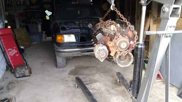

Yep, that's what I have, i acquired a 94 Ranger 2wd SCSB and ive always wanted to do a Solid axle swap and I'm doing research on that also, I want a truck that is fun to drive and will get me places I need to go, the TB is my daily so that's why I'm reading up on both trucks, if I swapped the Ranger I'd go with a D44/8.8 set up.. (Truck is already 8.8 swapped) was going to drop a SBC/Th400 into it
