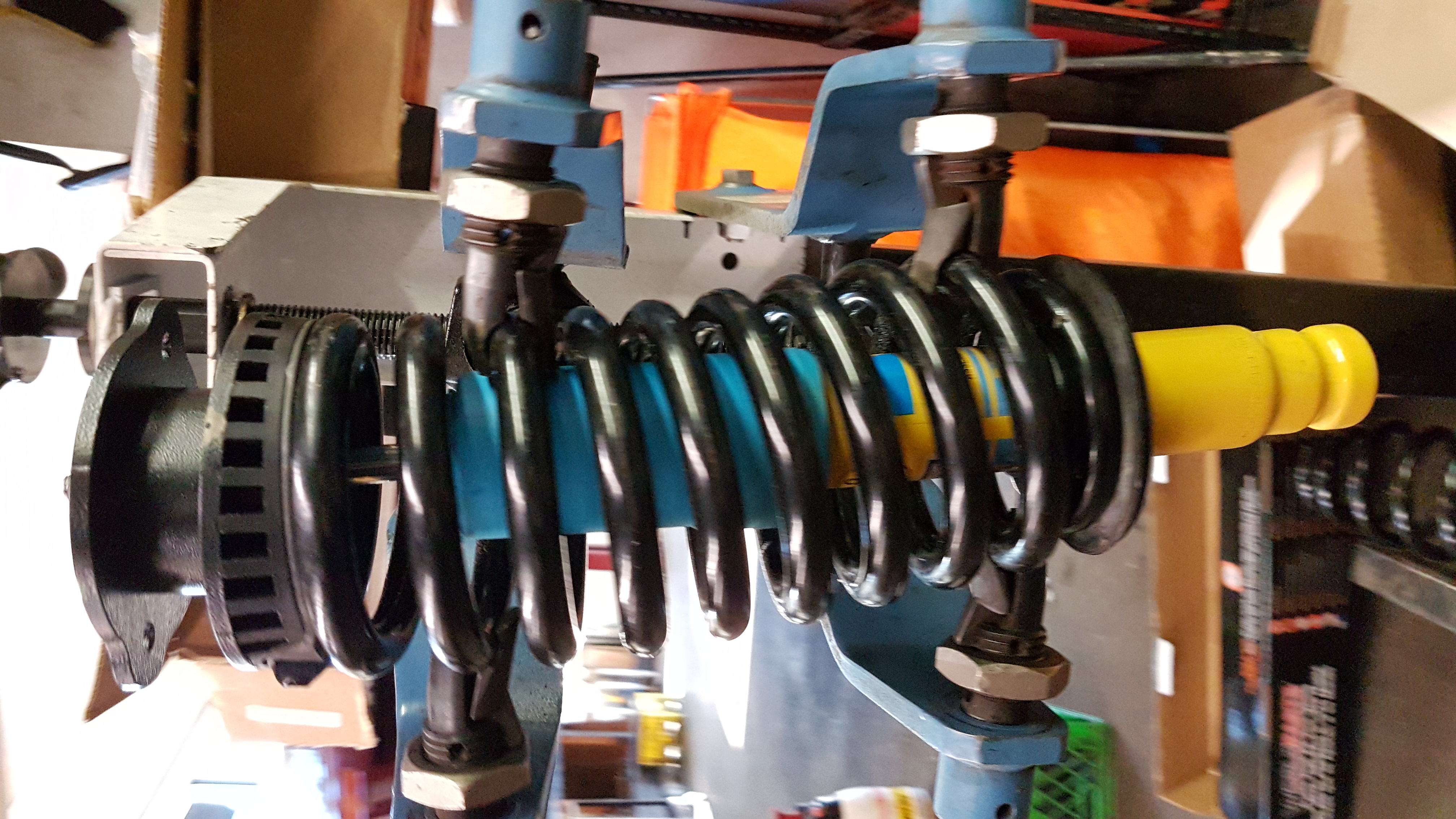

I just took my moog 81114 and 4600hd to my local tire shop to have them build the strut with the rough country 2" lift and for some reason the spring doesn't sit straight (see pic) does anyone know why this is happening as the tire shop has no clue.
I spent months looking online and researching using these parts together and asking questions on whether they would work and I really didn't get much of a response to say no it wouldn't. I just really need to know am I going to have to send back this Rough Country lift and if so what lift can I use in its place as we're pretty limited on an 02 Trailblazer EXT LT
Any help would be greatly greatly appreciated
Thanks

I am pretty sure that’s normal and will settle.
