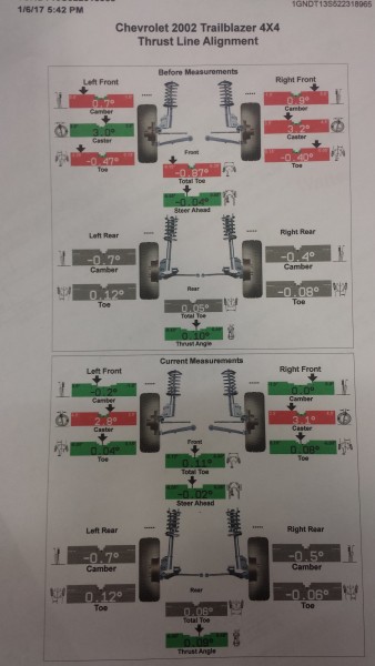

Was the alignment tech just being lazy?
by Timberwolf » Fri Jan 06, 2017 4:50 pm
My before and after sheet.
Pretty much looks like they didn't touch the caster. At first I chalked it up to maybe the lift changing something so they didn't have the option to adjust it. But after coming home and doing some googling... it looks like they just didn't bother?
Or am I missing something?
Upper control arms are brand new (bushings and all), and are flipped and swapped.
Timberwolf
Posts: 41
Joined: Wed Dec 14, 2016 11:18 pm
Location: Battle Creek, MI

by Timberwolf » Fri Jan 06, 2017 6:58 pm
I'm guessing they loosened the bolts to fix the camber, and the change in caster was just collateral to that process.

by HawkeyeC25 » Fri Jan 06, 2017 9:56 pm
Looks like they indeed set your caster. The upper control arms are not adjustable, but the lower control arms are used to adjust caster. But flipping the upper control arms puts the upper ball joints way forward which means they can only compensate so much with the lower control arm. You look like you are up against the limit for caster (I think mine is almost the same result). Looks good!

by Timberwolf » Fri Jan 06, 2017 10:57 pm
HawkeyeC25 wrote:Looks like they indeed set your caster. The upper control arms are not adjustable, but the lower control arms are used to adjust caster. But flipping the upper control arms puts the upper ball joints way forward which means they can only compensate so much with the lower control arm. You look like you are up against the limit for caster (I think mine is almost the same result). Looks good!
think so? they only moved it about a half a degree. I would have thought there'd be more adjustment in there than that? I keep seeing everyone say their alignment tech was able to get them back in spec (3° to 4°).
Now you have me nervous...

by rScherzer » Fri Jan 06, 2017 11:27 pm
I got my UCA's flipped after work today and then spent about 45 minuets adjusting the suspension. I figured I would sacrifice a bit of caster to keep the camber at or near 0.

by HawkeyeC25 » Sat Jan 07, 2017 12:38 am
Timberwolf wrote:I'd be much happier at 3° than at less than 1°
Your shop probably already put in a spec of 3.5 degrees so your readings are trying to get to 0 as a target! Which means you are closer to 2.9 and 2.8... Pretty much inline with everyone else. Good to go!!
PS There's no way you have 0 caster.

by rScherzer » Sat Jan 07, 2017 6:06 pm
Like HawkeyeC25 said some alignment techs like to set the machine to read 0 when everything is good. Its not the actual number of caster. I like to see actual angle numbers. 0 means nothing to me. The numbers would tell me whats going on. There are other angles like Included angle SAI. Im sure those are all messed up due to the spacer and lift.

by Timberwolf » Sat Jan 07, 2017 8:23 pm
Is it normal to do that just for the caster though?
Anyway, took it back today, and it is indeed maxed out.

by rScherzer » Sun Jan 08, 2017 12:42 am
What I do when it comes to alignments and vehicles that are modified, is first set it so it won't chew up the tires, then if there is room adjust it so it won't pull. Big tires are expensive and if I could get the tires to last a little longer then that the way I normally set them up. Some guys adjust just enough that it will work. That's mostly what I find with flat rate techs.
