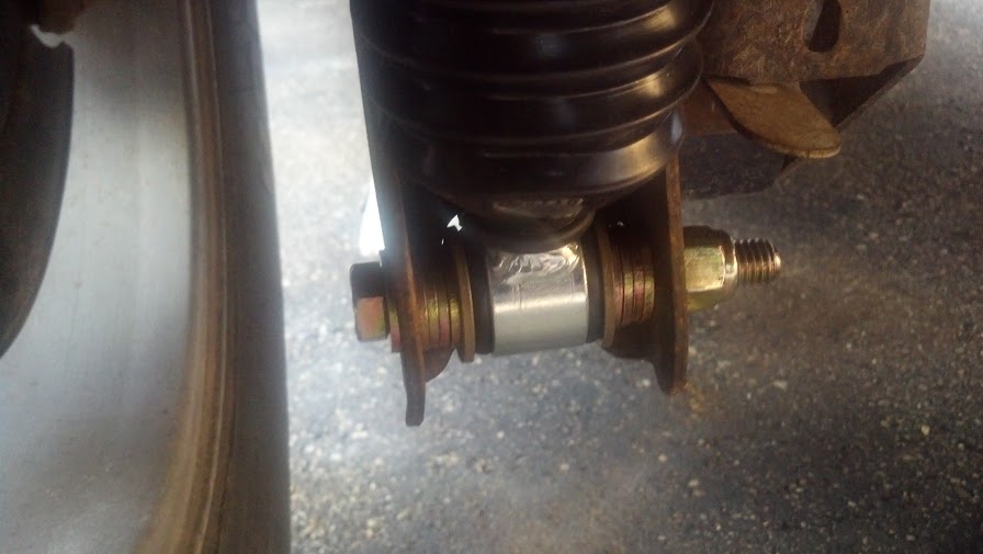

installed most of the lift today. Question about the rear shocks... The old ones had spacers to fill the gaps... the bilsteins do not. What are you guys doing here?

by ErikSS » Mon Dec 26, 2016 8:48 pm
Most people are using a few 1/2" washers on each side. A few people found and cut some 1/2" spacer to fit.
by HARDTRAILZ » Tue Dec 27, 2016 10:14 am
Bout like so
