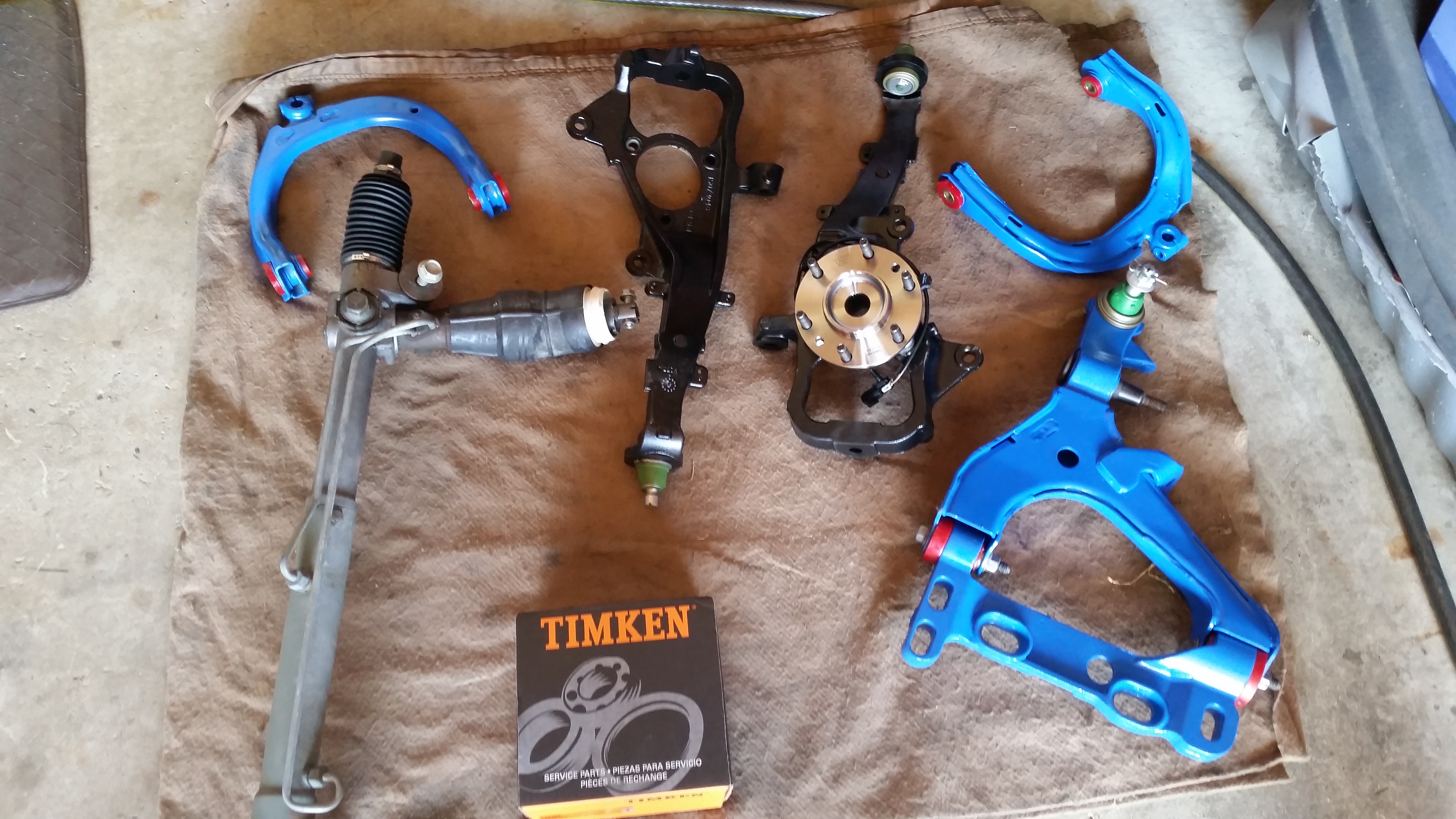

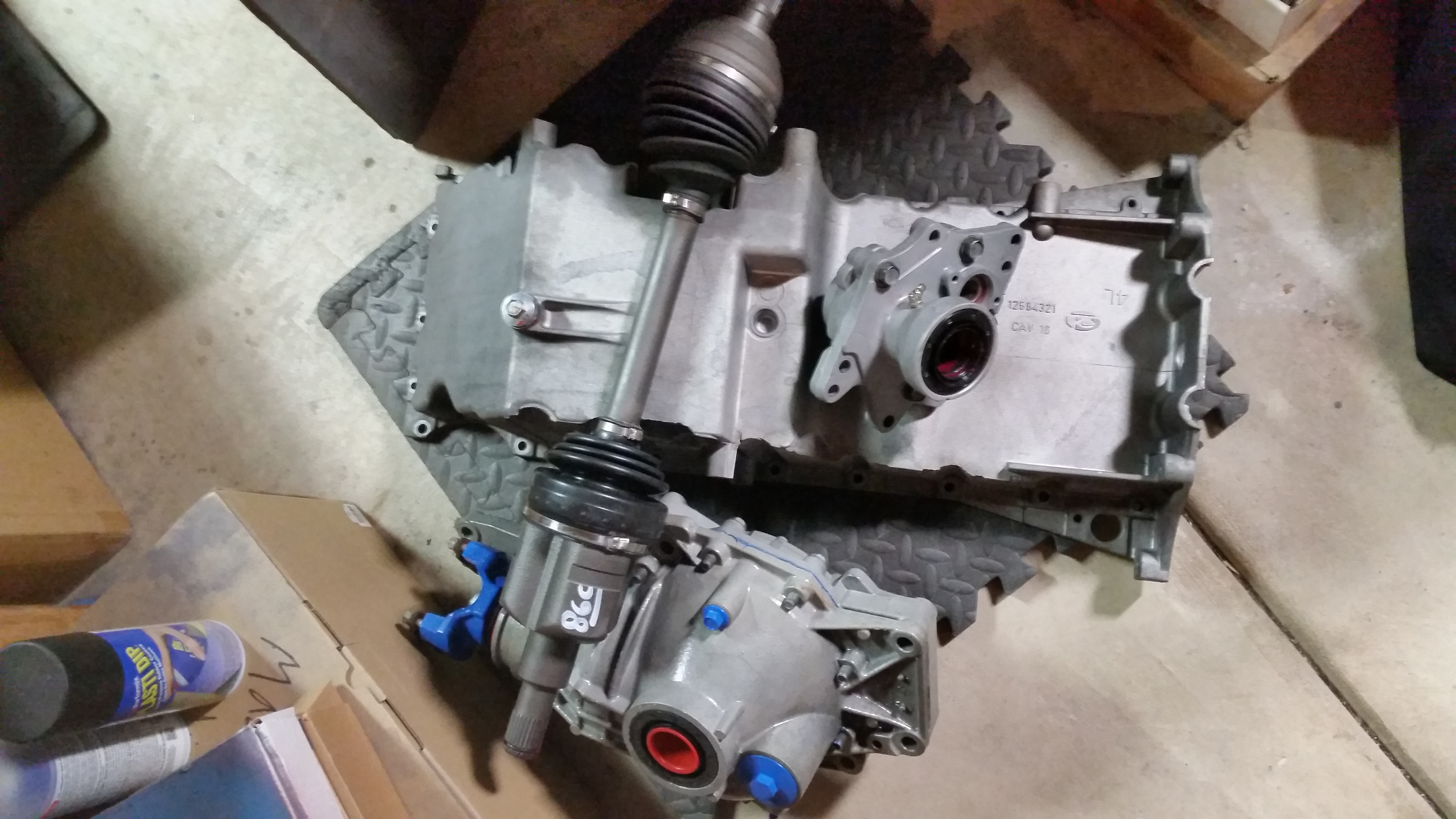

OK....so I swapped out my rear axle for a 4.10-posi from an SS..and so started the problem. Since I have a 4x4, it means I need to swap the front diff too. You think that would be a simple project....nope. Without having removed a part yet...here is where my apparent issues start....
As long as I'm changing a diff, needed to rebuild it, so all new thrust washers, bearings and seals are in it, so I don't have leaks or other problems and have to do it again. Can I buy standard parts ..nope, had to get Timken. Took the diff apart, and do you think I can just rebuild it and put it back together...haha...nope again. Had to beadblast it and clearcoat it for protection. The diff being done, of course I have to replace the disconnect. Same deal as the diff...but scored new gears too from American Powertrain.... Beadblasted and cleared as well...and of course added a zerk. Afraid I'll break something taking the old parts out...picked up a new oil pan. It's getting the clearcoat treatment as well. New front driveshaft...new universals painted and cleared? You bet. Soooo....As long as I'm digging all that apart, might as well change the wheel bearings. Timken...clearcoated...check. New axles from Detroit axles? You bet. Well....all that work and I don't touch ball joints? You jest. New Mevotech TTX all around. Do I want to screw around with taking the parts off, rebuilding them, and reintstall? No. Picked up used a-arms and knuckles from a yard in California so they were rust free. Stll...can't just install them as-is, so they were beadblasted and painted. What do you think happened next? You bet....those bushings maybe are bad???...of course...gotta change them. Stock replacement? No. Prothane? Yes. For the final touch...Since I'm going to drop the pan to change the diff (I know...but it's not that tough), that means I need to drop the steering rack. You know where this story ends right...? Upgrading to a cleaned/painted rack from an SS to get the quicker steering.
So I just can't NOT put new, upgraded, cleaned and painted parts on anything I touch. It's a sickness, obviously. Where does this ever end???
Pics of the diseases symptoms attached. Enjoy

by Anthony Hernandez » Sun Oct 09, 2016 3:44 pm
Great job man, I really like the color.
Posts: 399
by larryk » Sun Oct 09, 2016 4:38 pm
Anthony Hernandez wrote:Great job man, I really like the color.
Thanks. I'm trying to stick to a theme...suspension arms/springs that blue color, axle and knuckles black, and driveshafts (front rear and cv's) silver

by ErikSS » Sun Oct 09, 2016 7:51 pm
Holy Over Kill! It sure looks good, but "have too" is a pretty interesting concept in this write up. lol

by Trail X » Mon Oct 10, 2016 2:33 pm
I thought your truck had issues. Turns out its you?
Why would you bead blast the diff? Are you sure you didnt accidently blast any of the machined surfaces? That could give you some bad results.
They do look nice and new, but aren't you just going to get it dirty at some point?
Posts: 9935
by larryk » Tue Oct 11, 2016 9:26 am
Trail X wrote:I thought your truck had issues. Turns out its you?
Yup....I cant just bolt parts on without upgrading them/making them pretty :)
And yes, Im sure I didnt blast any critical machined parts on the diff. I did lightly dust up the mating surface for the RTV, so it will bond better....but all good otherwise.
Yeah, they are going to get butt azz dirty not long after I install them. But they will a)clean up better at the pressure washer, and b)in the Chicago area, with salty winter roads, I cannot STAND rusty parts. Also, as we all know, once lifted (as mine is) its only a matter of time until you have to replace broken parts. Nice clean, rust free, anti-seize coated parts are a lot easier to remove next time you have to go in :)
