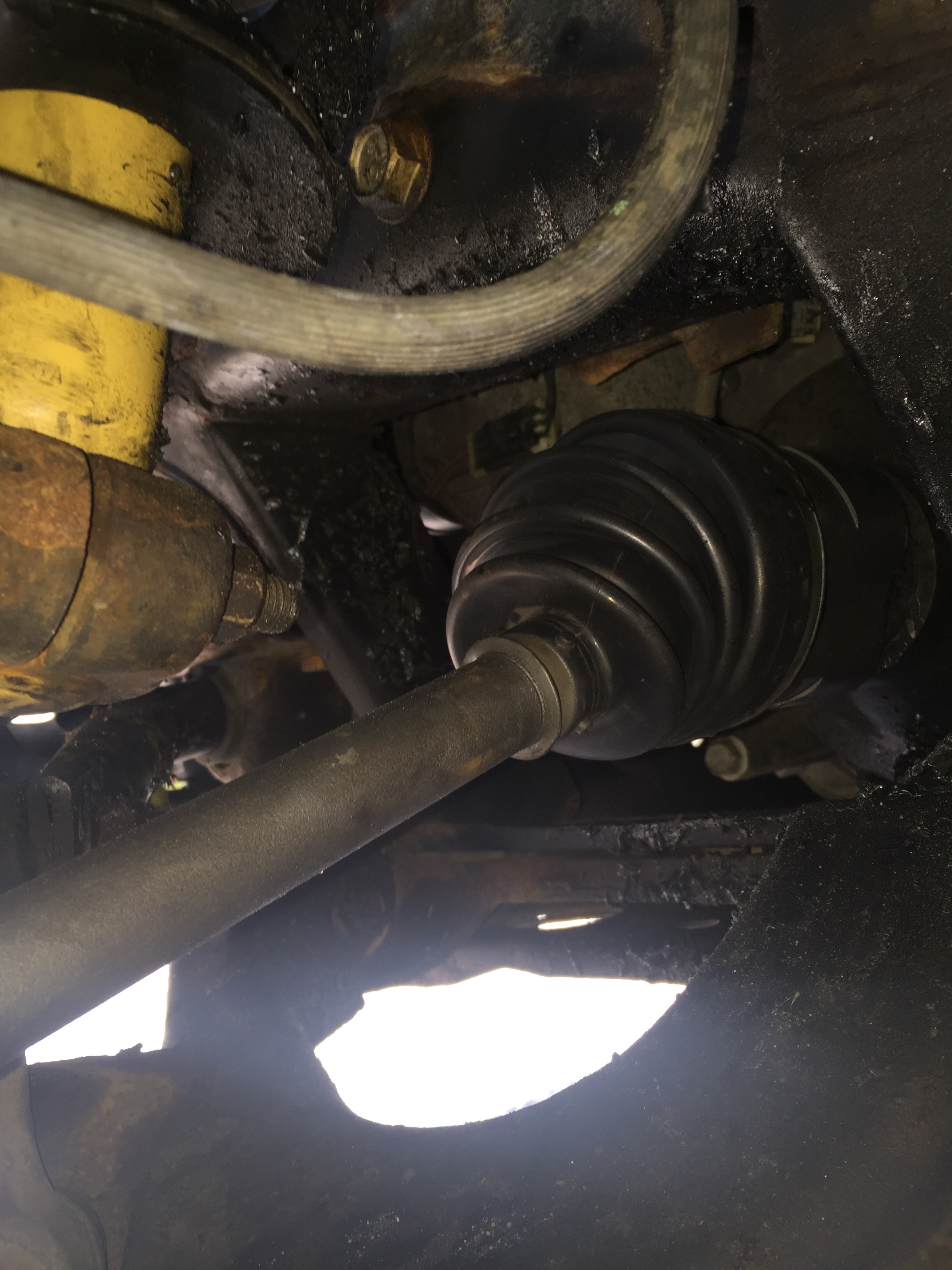

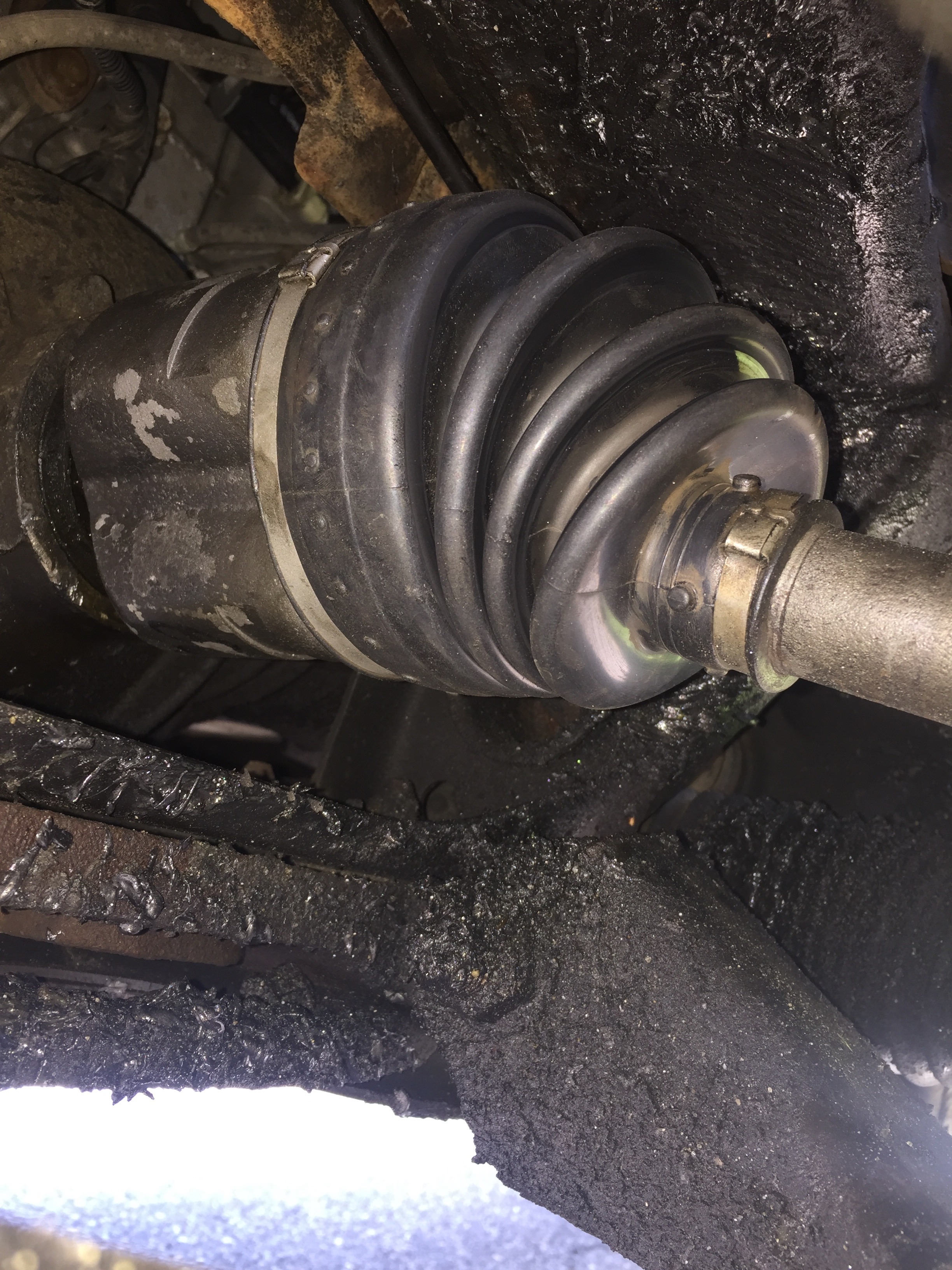

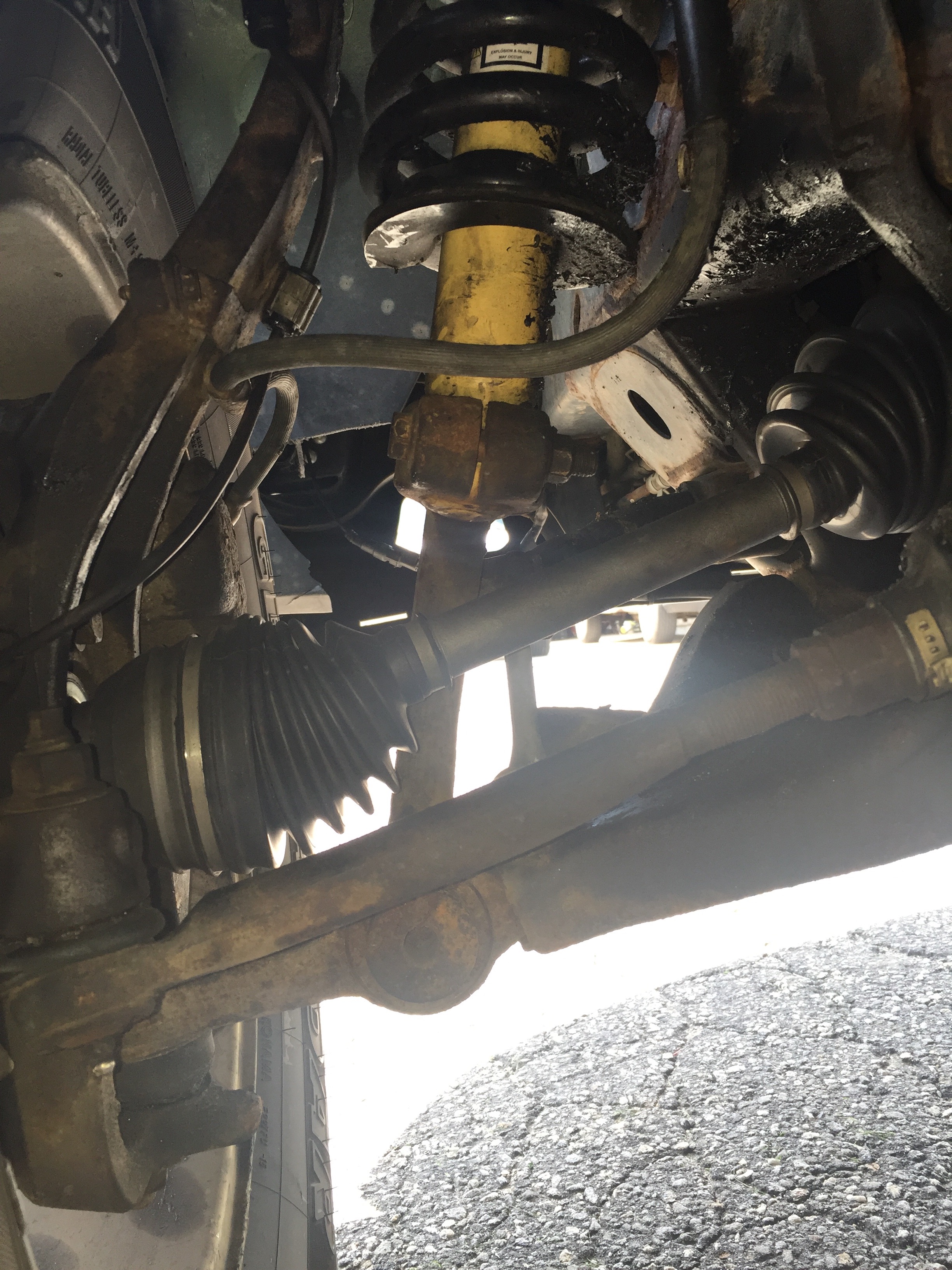

by Rickalicka18 » Tue May 17, 2016 3:33 pm
I'm not sure to be honest, but if I am still getting a shake from that side, then it must be... But when I lifted the tire off the ground with a jack and went to spin it there was no wobble or bind from what I could see, just rubbing from the brake on the caliper. Then from what it looked like, when I was taking out the cvs with the torn boot, the cv boot would tear then eventually bind up due to a lack of grease. BUT I could also be wrong and the cv could be binding from the start then the boot eventually tears, then it just keeps binding worse and worse.
I don't think that my actually gain in height is 4" exactly because I am just going off of the fact that I bought the 3" lift and since I went from 84s to 87s that I got about 1" inch of lift from the springs (which my calculations could be wrong). I think it is more like 3.5".
Here are some pictures of what the new cv looks like in though.
Drivers side
Drivers side
Rickalicka18
Posts: 502
Location: Sabattus, Maine
