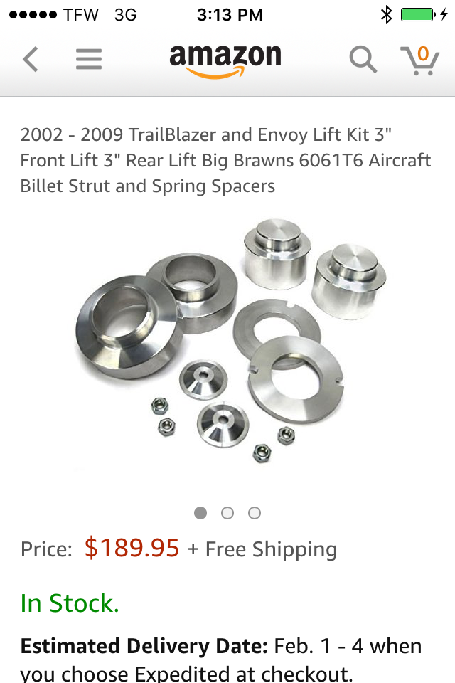

by Trailblazer1 » Sun Feb 28, 2016 5:28 pm
This is the kit off amazon I bought
This is what I bought

by TBYODA » Sun Feb 28, 2016 8:38 pm
that's a copy of MarkMC 2.5" lift kit
Posts: 1762
by Jrgunn5150 » Sun Feb 28, 2016 10:45 pm
Copying Mark seems popular lately lol.
