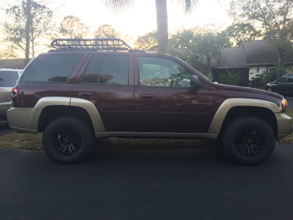

There isn't much info available on this combination and just wanted to let everyone know I am super happy with the results. The build is as follows:
-Front: Moog 81112 springs, Bilstein HD struts and Markmc 2.5" lift kit spacers (Approx 3.5" of lift)
-Rear: Moog 81069 Z71 replacements, Skyjacker N8030 shocks and Markmc 1" rear lift spacers (Approx 2.5" of lift)
-MB TKO wheels with +25 offset and 265/70/17 BFG Ko2's

Actually I have an MDB Bumper coming, so seeing how your's is sitting stock, tells me I may want to go up one notch on front springs.
by Brendon » Fri Feb 12, 2016 2:18 am
Jrgunn5150 wrote:Actually I have an MDB Bumper coming, so seeing how your's is sitting stock, tells me I may want to go up one notch on front springs.

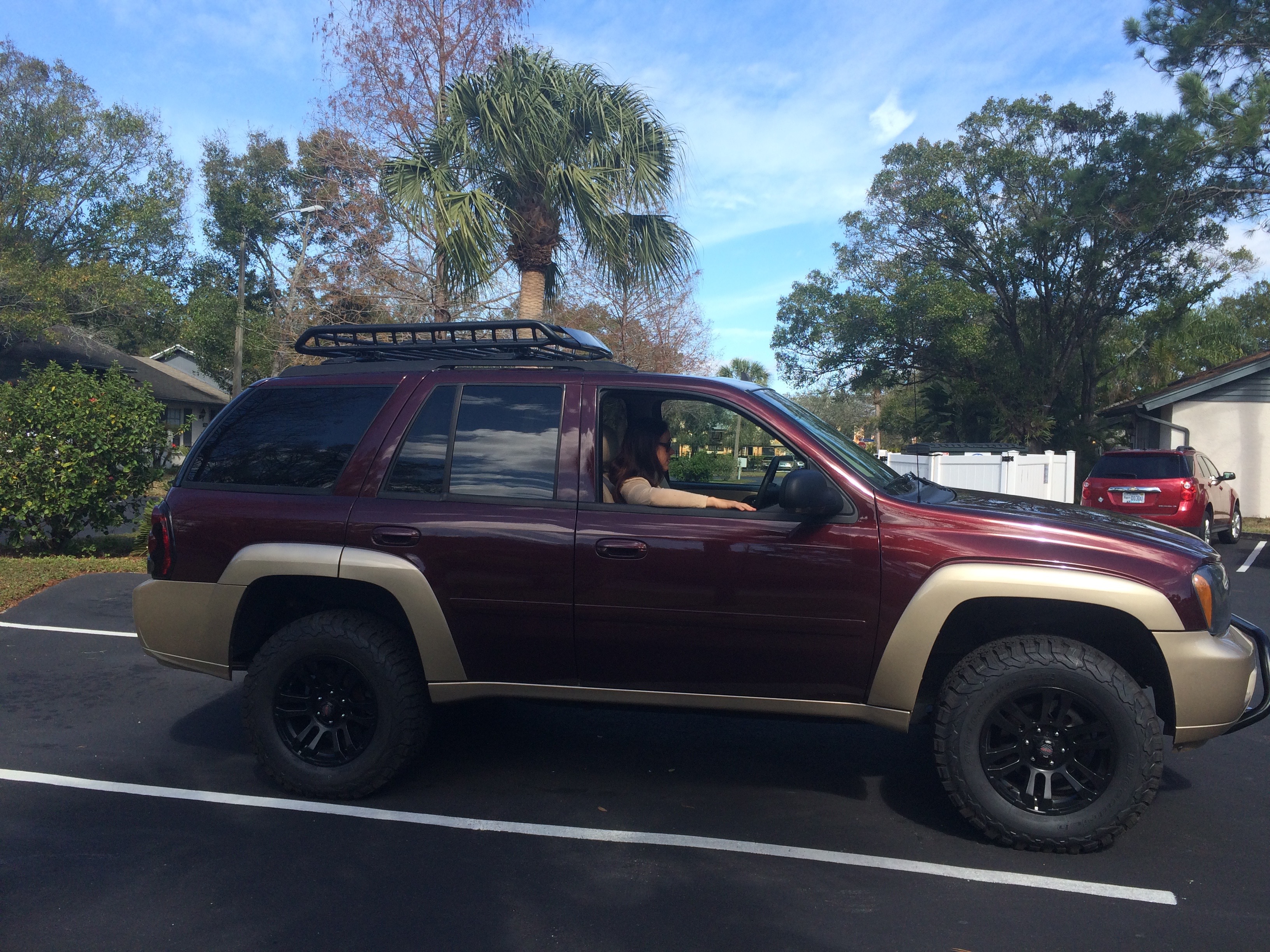

Ya, I guess it depends on how you want it to sit when it's done. In the pic I posted my rear was a bit on a hump. Here is another photo to give you another view. It has very little rake in the rear...maybe 1/2". But with a heavier bumper it certainly would be more. Remember I have 2 1/2" lift kit in front and only 1" spacers in the rear, not sure what your setup is. From what I have read the Moog 81114 will give an additional 1/2" or so in the front. Hope that helps.
