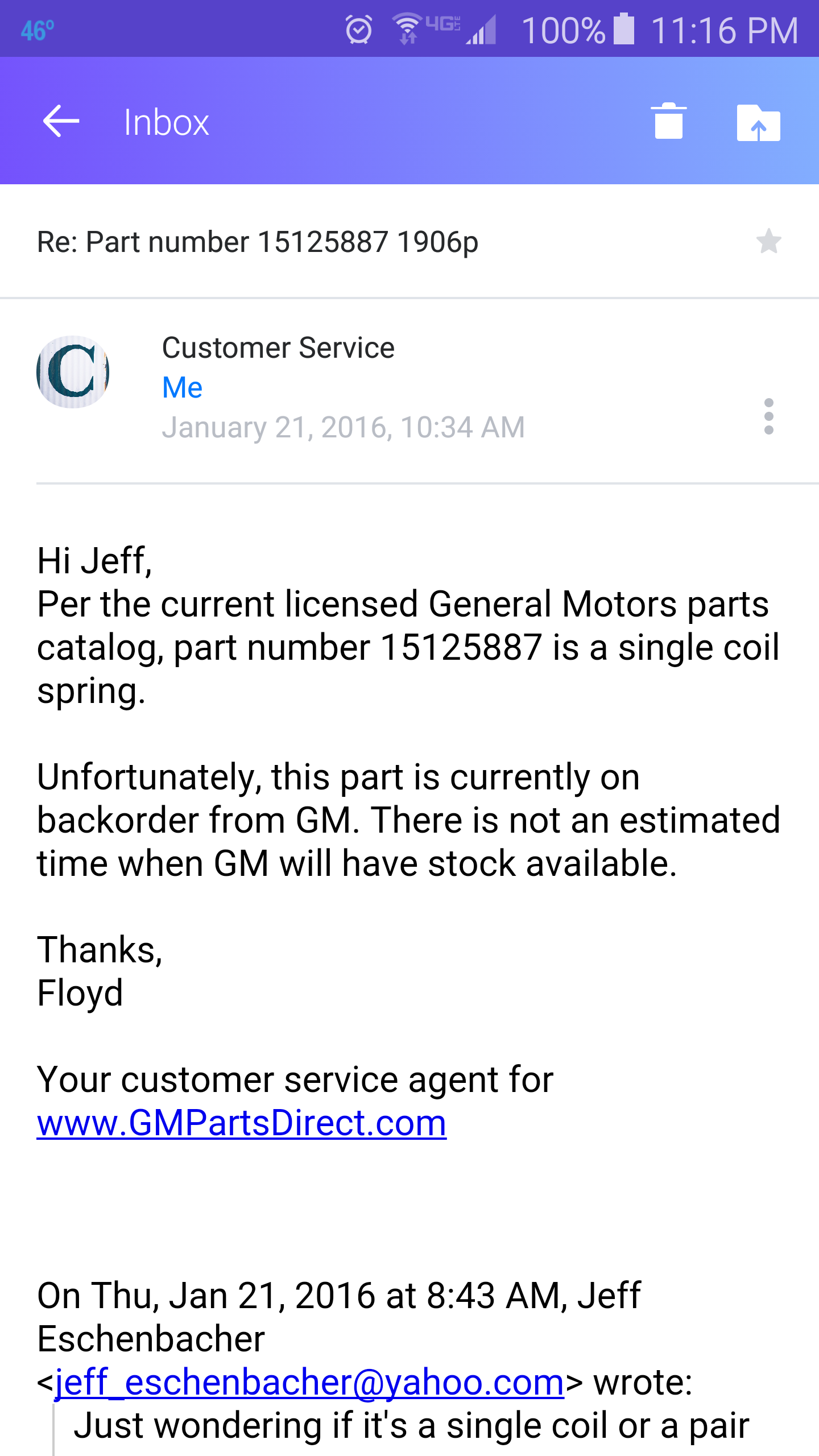

Anyone know of any place to get them? Or what would be an equivalent spring? emailed GM parts direct and they have no estimate on when they will be back in stock

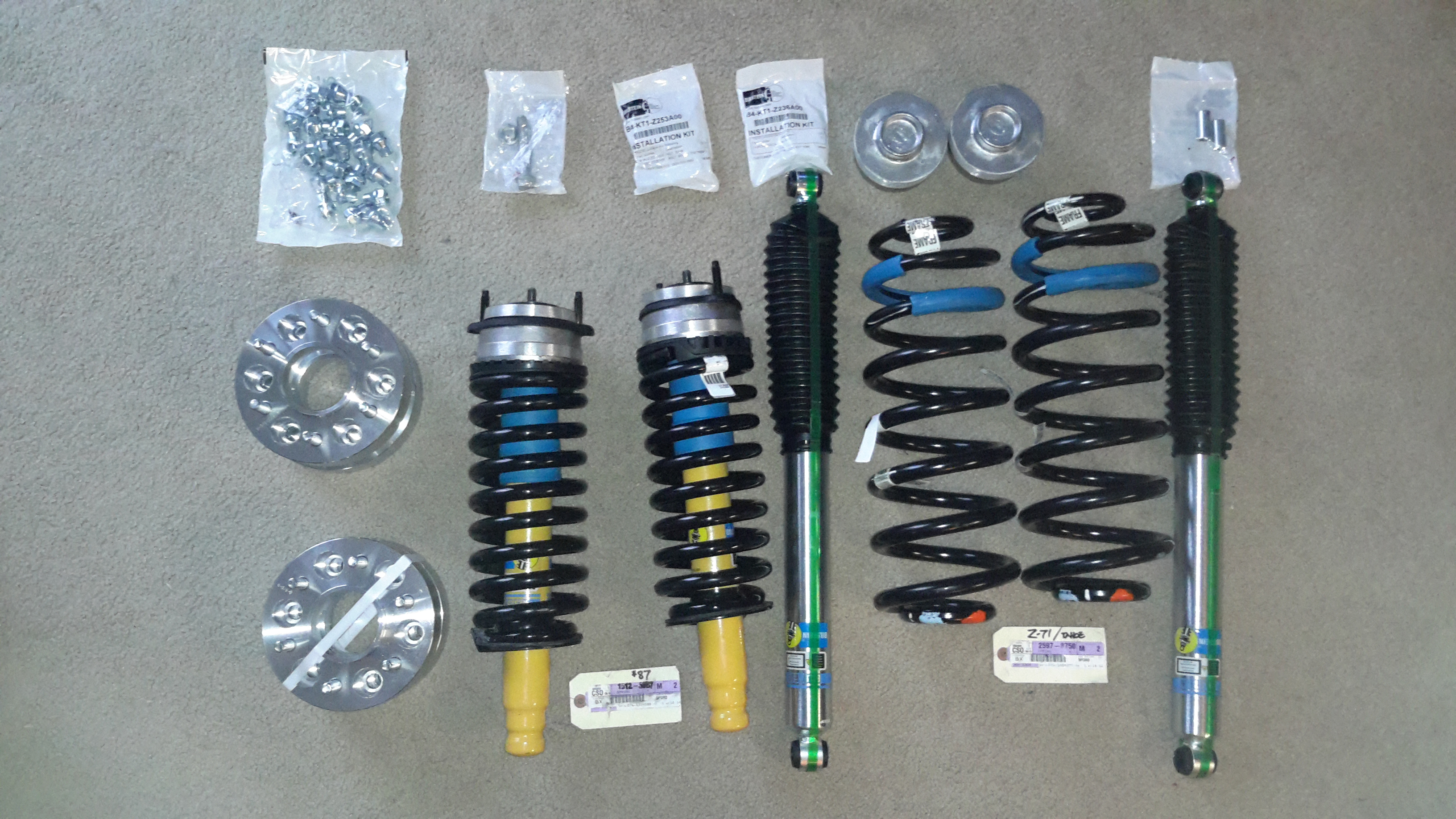

thank you! yeah my dyslexia kicked in I meant to type 151 not 515...(-_-)anyway now that my suspension has settled I cannot for the life of me figure out why I'm sitting at 39" in the rear but only 37" in front...I have moog Z71 springs and mark's 3" front and 2" rear suspension lift with the hoe springs it should bring the rear height up 3 1/2" correct? any idea's?

I have 245s so you would add 2" roughly to compare with me, but I have 87s out front, z71 in the back, hd bilsteins struts in the front, got some hoe hd bilsteins shocks in the back with the same lift and I measure 36" up front and 37" in the back... So your rear measurement seems right to me... Cause mine are the same. Now that I think of it though I put my rear going up 5" in the back in my build thread.. Lmao.. Might help if I had gotten the rear measurement before..

Yeah that's my problem too...anyone know what the stock ride height is? Ive got skyjacker shocks, moog 4wd Tahoe spring's in rear, moog 4wd trailblazer spring's in front with belltech street pro struts according to the measurements by others both sets of spring's should add about 1 1/2" of lift which with marks lift should bring the front up to approx 4 1/2 and the rear to 3 1/2...I removed my rear spacers and I'm sitting perfect 37" front and back I just don't understand why my numbers were so off/backwards so I have a 1 1/2" lift in rear and 4 1/2 in front...makes no sense...

by eschy1990 » Mon Jan 25, 2016 1:34 am
My email from GMpartsdirect

by Rickalicka18 » Mon Jan 25, 2016 2:35 am
I would almost assume that gm would of made the rear springs more stiff in the back than the front, making the rear high than the front. And I know that my front measured 32" ground to fender. The rear couldn't of been anymore than an inch higher than the front... I would think.....

by Jrgunn5150 » Mon Jan 25, 2016 3:51 am
eschy1990 wrote:My email from GMpartsdirect
Well I guess that answer's that lol.
by eschy1990 » Tue Jan 26, 2016 9:53 am
So the front sounds about right at 37" I took out the spacers in rear and it's back down to 37" so I guess it would be around 1" higher if I had stock spring's all around...it's just weird that it takes 4 1/2" in front to level it out with Z71 spring's in rear and no spacer, with 81114 spring's In front
