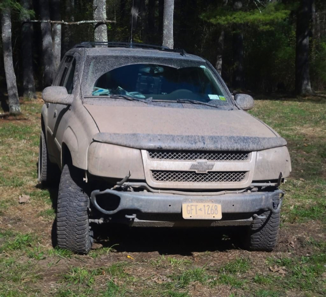

Midnyteryder196 wrote:. I will for sure look into removing the sway bar then. Do you guys usually completely remove the sway bar or just take the end links out?
You'll want to remove it completely or this could happen on the trail.
viewtopic.php?t=5264#p104247
Then you'll be doing trail delete, like I did at last springs TECORE?
However the sway bar does fit nicely on the front bumper. :lol:
