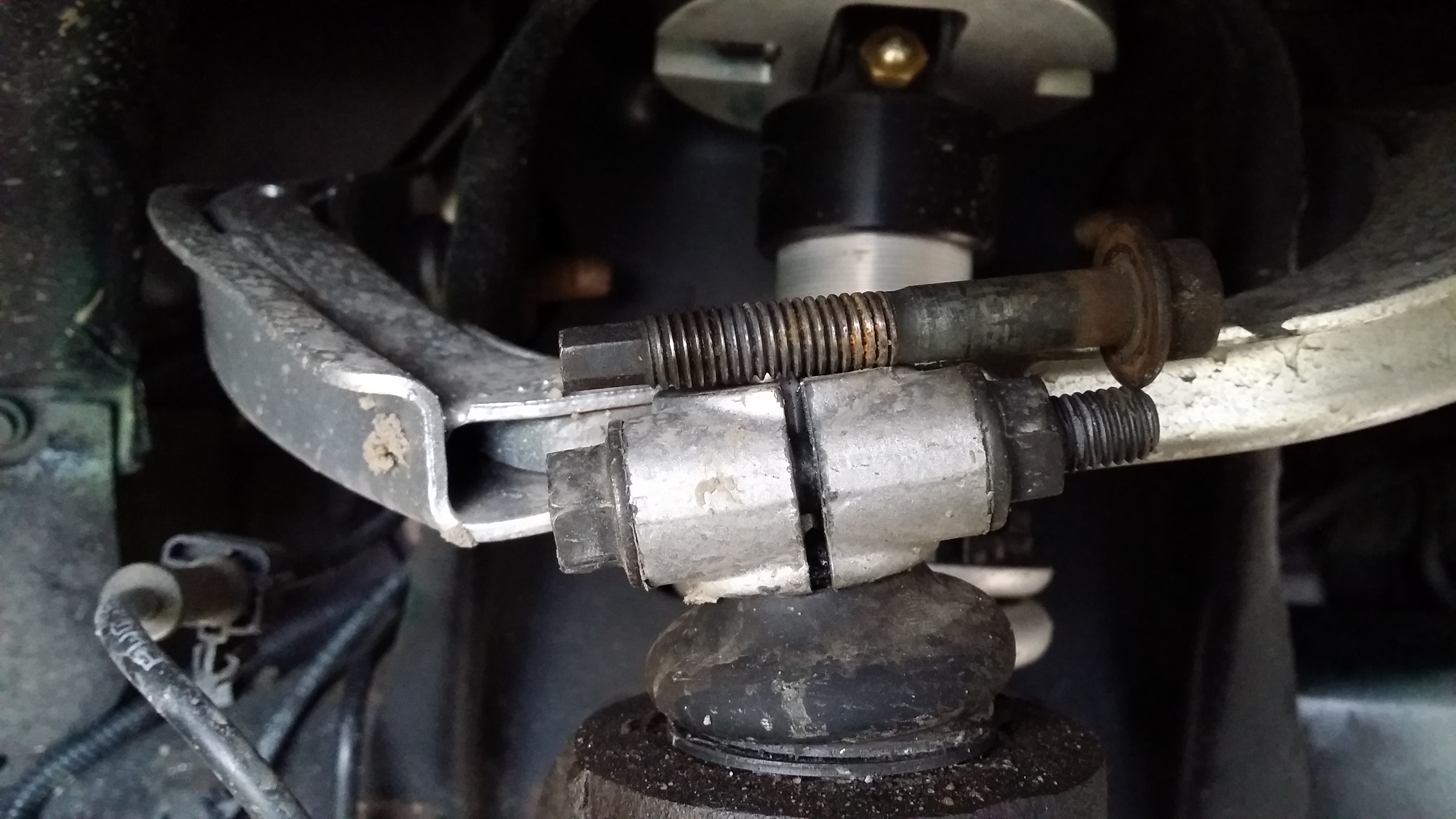

Did you happen to also replace the balljoints while doing the lift? The reason I ask is that the new bjs come with a bolt that is threaded all the way to the end of the bolt, while the OEM bolts have a narrower hex head at the end. (See my comparison pic below). Due to the narrow end, the OEM bolt acts as guide and can help realign the UCA's bolt hole with the bj's bolt slot, whereas the Moog (or whatever aftermarket brand) bolt tends to just bind up if the two are slightly misaligned. The remedy I used was to tap the OEM bolt through to seat the UCA and bj. Then, I knocked the Moog bolt through on the opposite end, which allowed me to use the new bolt while forcing the OEM bolt back out.
As Andrew mentioned, unbolting the UCAs from the frame could give the UCAs some more freedom. Also some white lithium grease or other lubricant on the clean bj shaft should help to alleviate any binding issues of it being at a slightly different angle than the UCA when trying to mate them.
