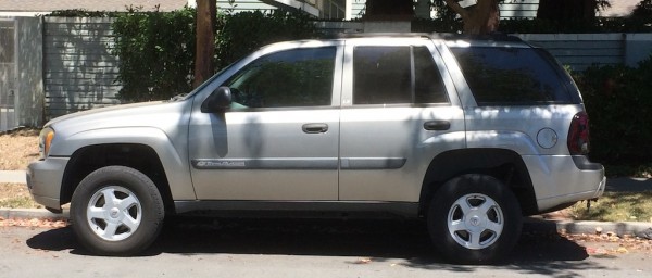

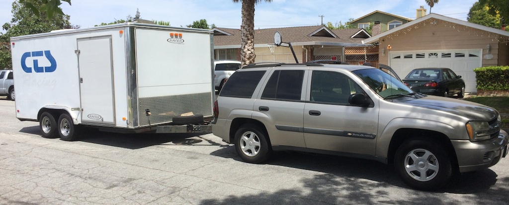

I basically want the truck to sit level. I will be towing a 8x16 enclosed trailer a few times a year across the western states. here is how it sits now
Trailblazer with trailer

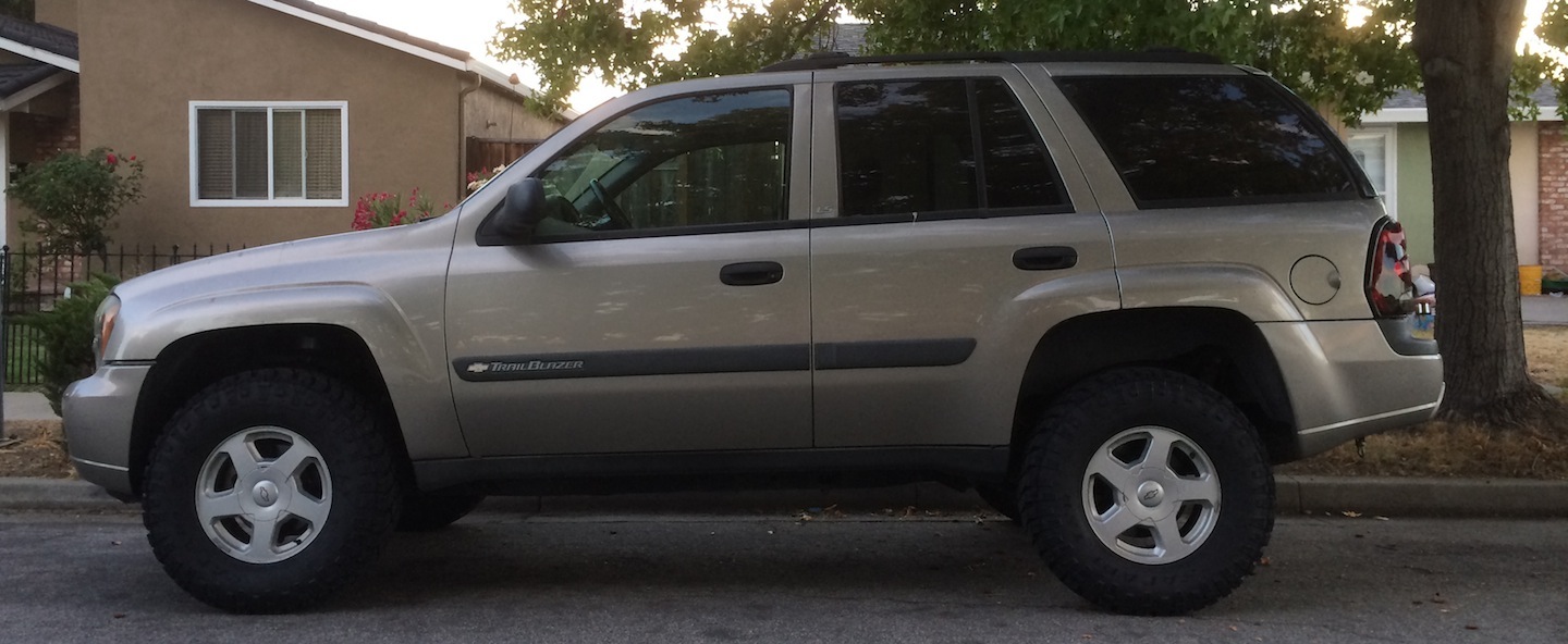

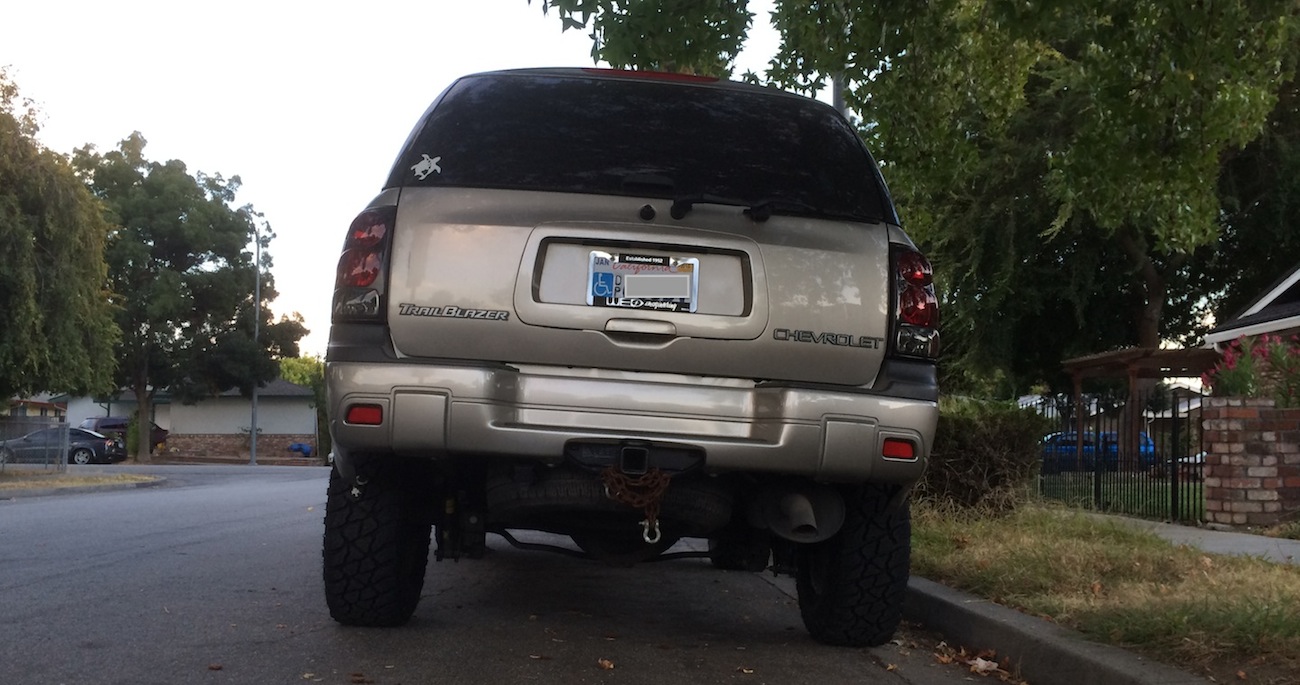

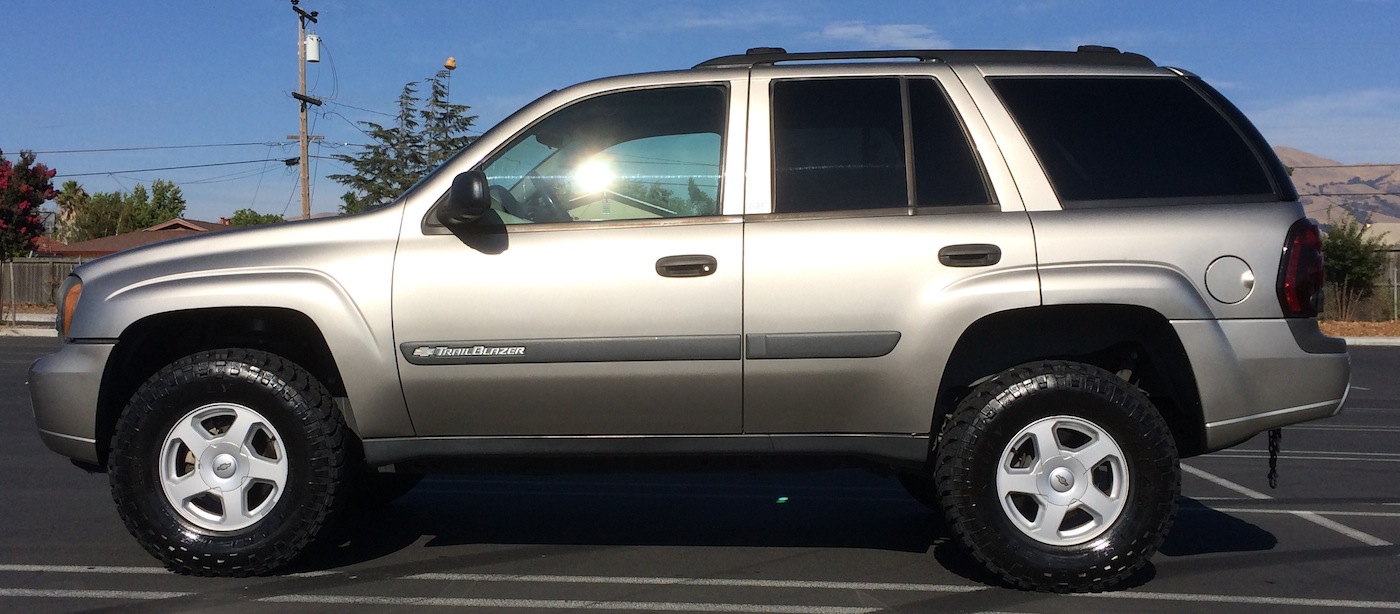

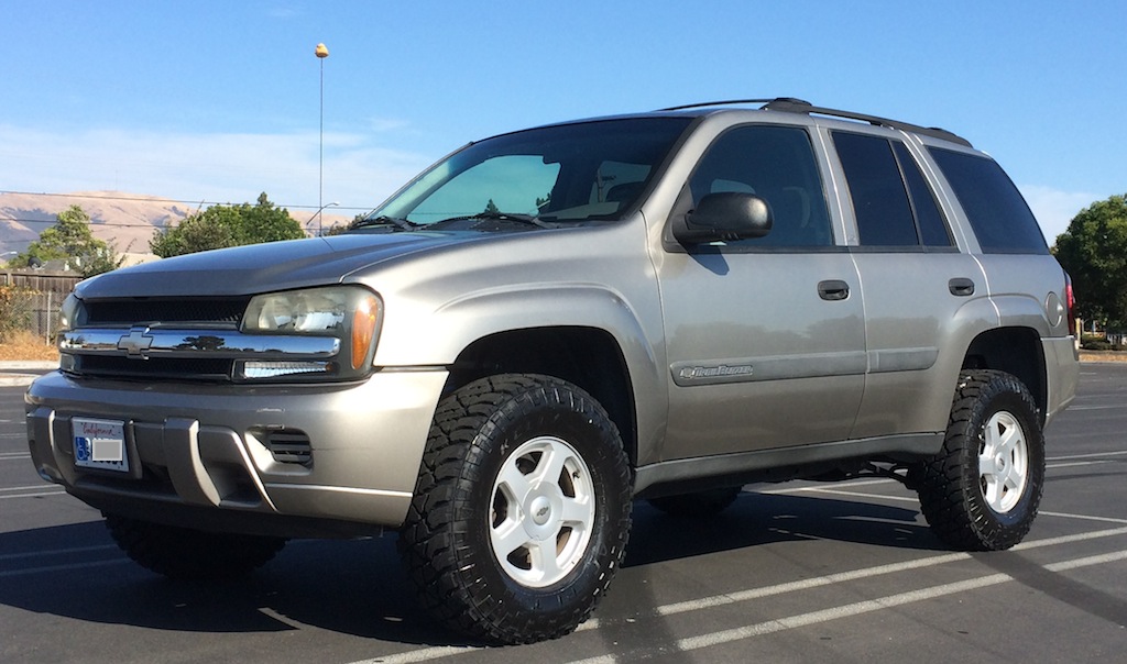

by nvrs » Sat Aug 02, 2014 1:17 am
Picked it up today... Still need to put the longer rear shocks on but it came out ok...

by Trail X » Sun Aug 03, 2014 2:15 pm
Looks good to me Lonny, no need to remove that block.

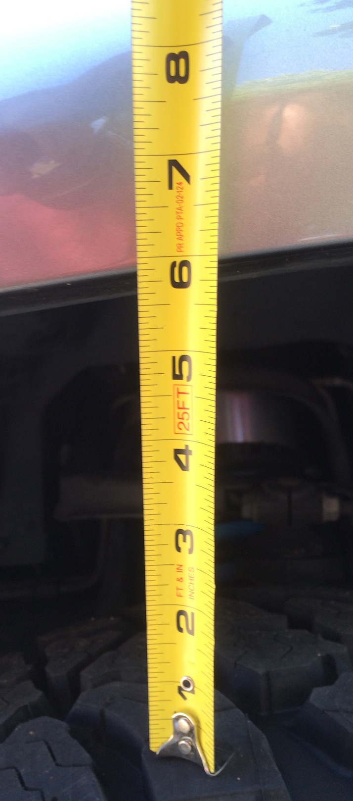

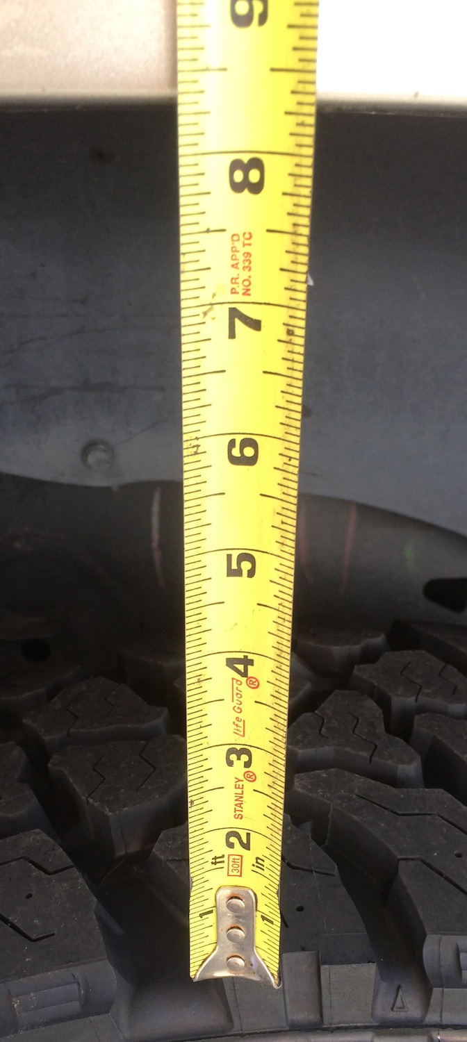

by nvrs » Sun Aug 03, 2014 7:25 pm

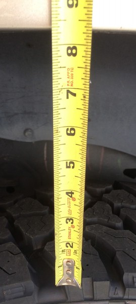

I'm just not sure... while driving, I seem to be looking at the ground. Here is the back measurement pic. 8-5/16" in the rear and 6" in the front. I may change to a 1" block or no block.

by ErikSS » Sun Aug 03, 2014 7:46 pm
I feel that for those of us who tow, having a little rake is a good thing. That way the truck sits level while towing.
How many miles did you have on the lifted truck when you took those pics? Often the springs "settle" in and your height changes a little. I've seen it take a couple hundred miles.

by TBYODA » Sun Aug 03, 2014 9:37 pm
I have Z71 and 2" spacer also and measure 8" from top of tire to fender. Up front 6.5" I've had my lift on since March and the Z71 were used so I am sure they have settled.
