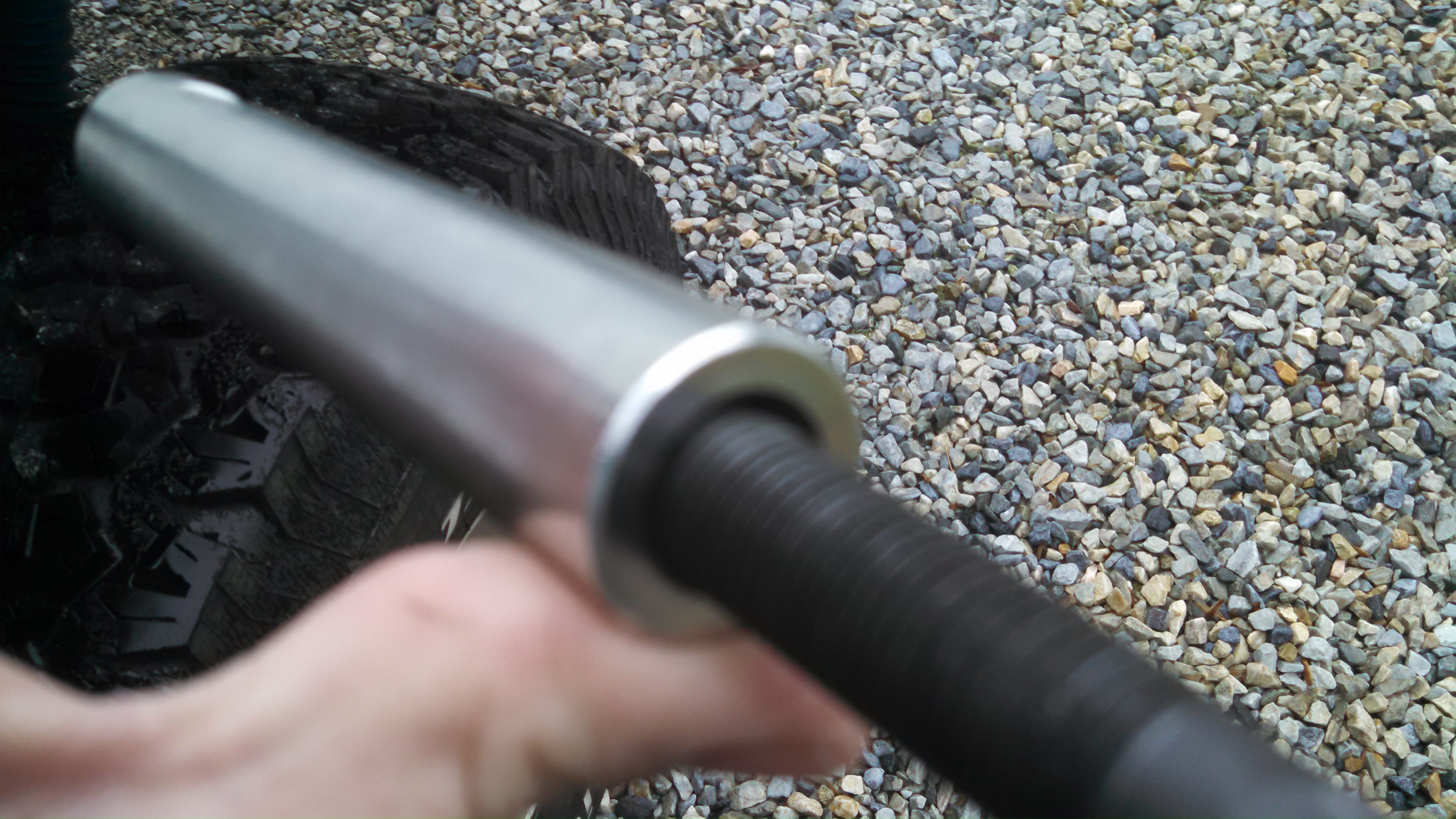

2500HD TRE RC Sleeve
by Norcrosski » Tue Dec 23, 2014 6:19 pm
Here's one

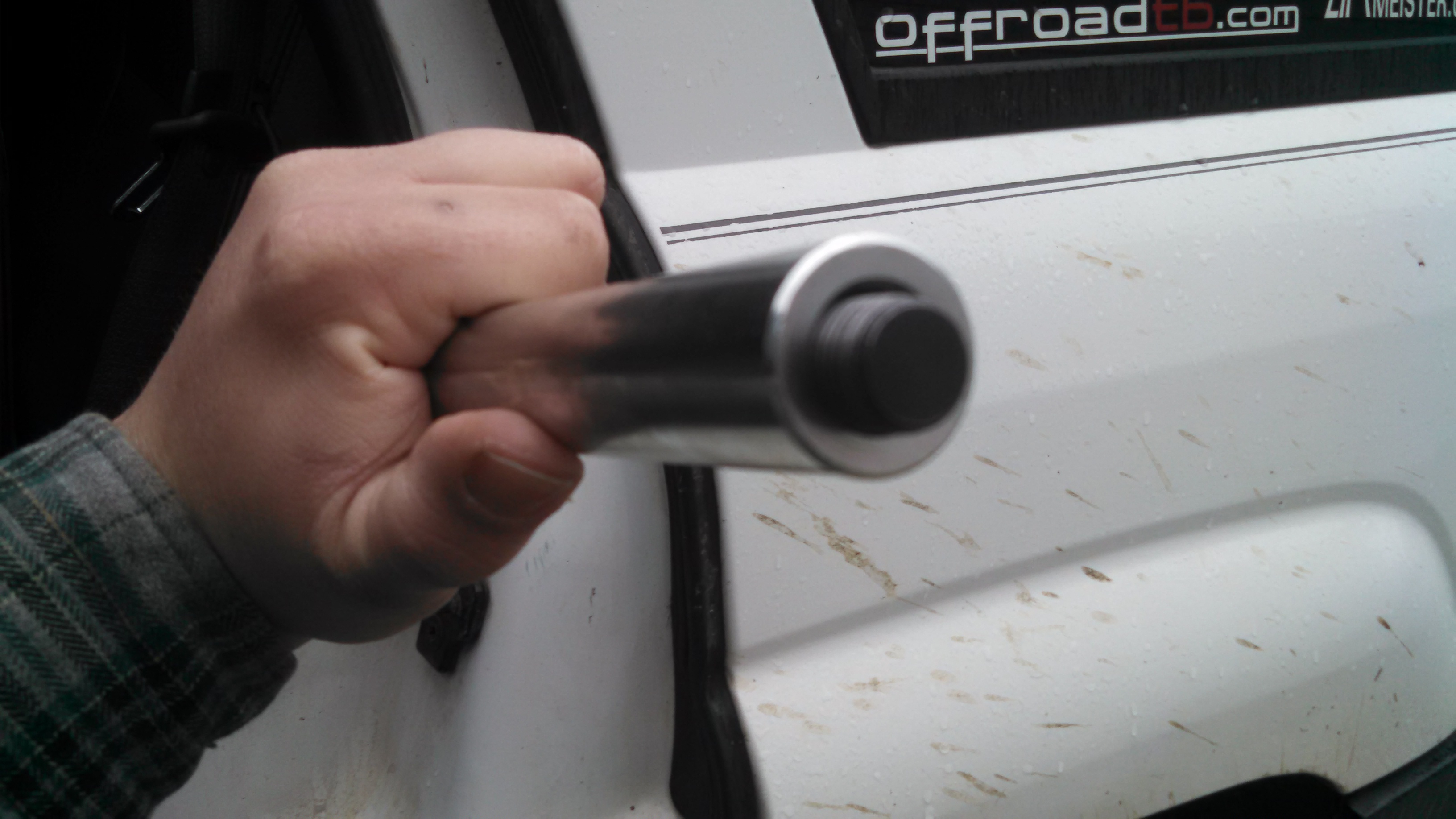

by Norcrosski » Tue Dec 23, 2014 6:22 pm
Here's another

by v7guy » Tue Dec 23, 2014 9:10 pm
Is it the right TRE? Do you have a pair of micrometers you can measure it with? Maybe the wrong part put in the packaging? The sleeve won't fit the moog without reaming, it shouldn't even slide over it.
by Moots1288 » Tue Dec 23, 2014 9:51 pm
but it does fit Ac Delco perfectly, maybe the aftermarket is smaller. I did have that problem with the bushings in Mevotech being a thousands of an inch off?
by Norcrosski » Tue Dec 23, 2014 11:56 pm
I tried an ac delco today at a dealership and it did not fit it same issue a buddy replaced and outer today on his 2500hd and same issue I have the correct inner and outer tie rods so far I've tried it on 9 different inners

by Trail X » Wed Dec 24, 2014 12:48 am
I wonder what year you're getting parts for. I recall there being a diameter change similar to our 14/16 mm thread change. I bet you have old 14mm thread tres and you probably need 16mm tres.
Posts: 9912
by Norcrosski » Wed Dec 24, 2014 1:18 am
I found out the 07 inner will thread into my rack correctly and I did have stock 14mm but it will work so iam happy with tht

by Norcrosski » Wed Dec 24, 2014 10:20 am
01 to 10 2500 hd takes 1144 this is my falut I have always had good luck just pulling part numbers from here and not having to double check them

by Trail X » Wed Dec 24, 2014 11:45 am
Sorry, so what was your resolution? You got the 16mm HD tres and it worked fine with your rack and the sleeve?
Posts: 9912
by ErikSS » Wed Dec 24, 2014 12:06 pm
So it was the wrong sleeve? I hope we didn't posted the wrong part number.
Posts: 2031
by Norcrosski » Wed Dec 24, 2014 12:14 pm
I called rc today they told me 1103 was a sleeve for 1500 but tht 1144 was the sleeve I needed for an 07 2500 tie rod but they are letting me swap I just have to pay to ship the sleeves back tht I already have
