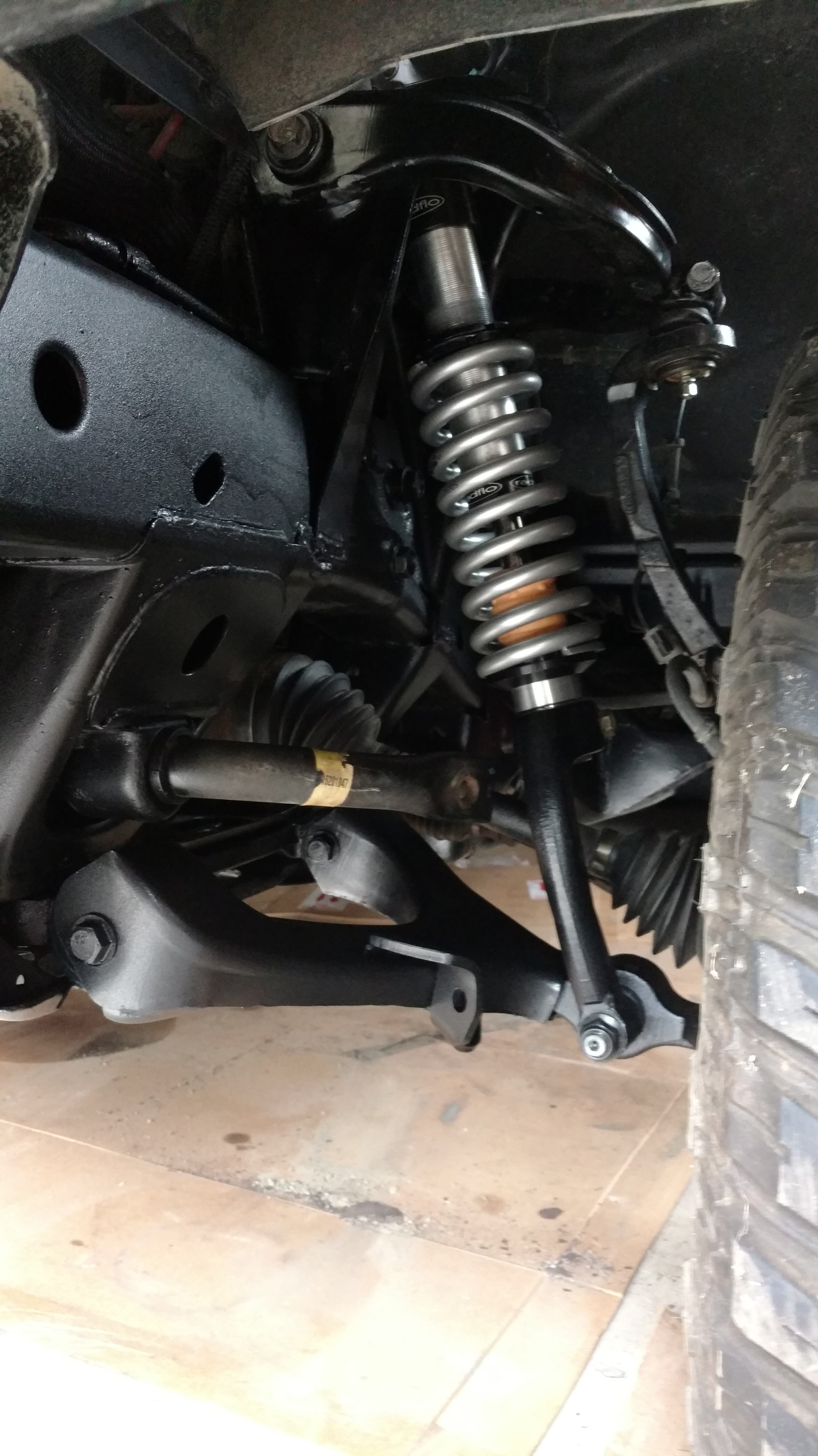

No that is not correct. The spring is under compression all the time even when it is out of the vehicle (why do you think people have to put them in a vice to adjust them outside the vehicle). The collar only adjusts pre-load and has no affect on the overall length of the shock.
I'm talking about overall length of the shock which directly affects maximum droop. So I'm asking if anyone has thought about putting a top spacer in to increase the droop.

Craig, you're right, the collar does not adjust the overall shock length. Noone to my knowledge has spaced down the radflos, although it has been mentioned once or twice before. That may be because there's such a night and day difference as is that I think noone has felt the need yet once making the transition.
My only concern is that the radflos reportedly have an internal bumpstop inside the shock. This is meant to absorb the forces of the weight of your suspension being thrown into the shock piston when the suspension unloads. I imagine they have added some sort of internal rubber bump-stop that would squish down to absorb the impulse load. My point of this is that if you were to unload the suspension such as Robert did when he did his infamous Trailblazer jump, the radflos may reach the same max droop point as your current suspension, if only for a split second while absorbing the load.
I'm not telling you not to try adding a spacer, I'm just cautioning you that there may be some dynamic element that we're not seeing when comparing them side-by-side.

Wow - Great point James! I never thought of an internal bump stop being the reason for the difference in length! I'll have to shoot an email out to Radflo and see what they say. I was thinking I could loosen the top nuts on the radflo's to let them drop and see if another 1/2" (or even 3/4" - 1" to account for any internal bumper) would create any binding in the CV's. If not, I might go with MarkMC's 1/2" top spacer from his 2.5" lift kit. Think he would sell these by themselves??

No I never plan to get near stock, but if more down travel is available I would rather have it to maximize my articulation and minimize how much it runs into the internal stops of the shock on full droop. With the preload cranked up where I'm happy with the ride height, I'm already pretty limited on down travel so just looking for a bit more if possible.

From Glenn at Radflo (good call James!)
"Hi Craig,
The shocks do have an internal droop stop. It is a steel and rubber compound, so it will not stand up to constant abuse.
I am happy to hear you are pleased with the shocks.
Regards,
Glenn"
So I think that explains the difference in length. Either way, I ordered up the spacers from MarkMC :) Guess I'll be the first one to give it a shot!

by HawkeyeC25 » Wed Oct 05, 2016 12:08 am
Hey all,
It's been a while since I've done any updates. Earlier this spring I went and put the MarkMC top spacers above the Radflo's with GREAT results! I regained the inch of down travel I had with KYB's and to date I have had no binding issues. It gave an immediate overall lift of almost an inch, which I had planned to compensate for by adjusting the collars and just having more down travel. But after seeing it look closer to the rear lift, I decided to keep it higher :) I think it looks much more level now. So I'm around a 4.5" lift overall now front and rear.
I've driven this setup pretty hard all summer (jumped the front end off the ground a few times on whoops) and I have had no problems.
Hope this review helps!
