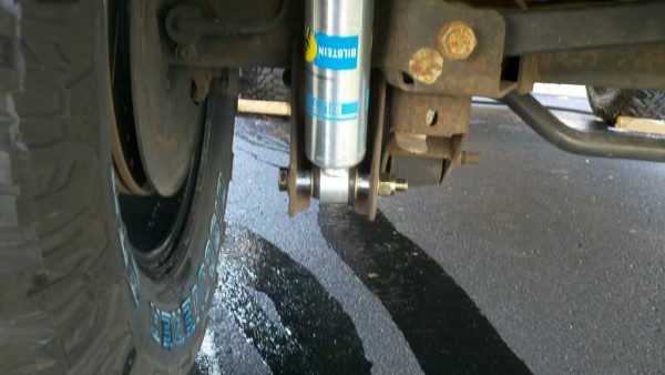

Anyone else experience this?
Also my rear end wheels have a ton of positive camber, asked on trailvoy which I feel is a dead site now.
Thanks guys
I had a squeak in the front markMc 2.5 lift and I sprayed the upper mount with some white lithium grease and it was all better. In the 2 years I had that lift I sprayed it twice once I started using white lithium grease, I used oil but that ate away at the rubber bushing.Nexus1155 wrote:Installed Marks lift kit in the rear with skyjacker nitros. The lower strut spacer with washer situation is a little weird so I stacked more washers in to make it a tight fit but everything still squeeks when I am driving down the road and I feel it is from that location since the poly mount does not fill the space well. Or is it the added lift spacer?
Thanks guys
agreeThe Roadie wrote:Those washers are too small. They need to be as big as the poly bushing to compress and expand the bushing.
