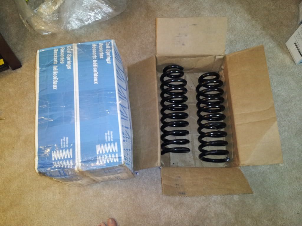

by snowmirage » Thu Jun 28, 2012 5:01 pm
Well looks like I screwed the pooch..... :wallbash:
So.... when I ordered these from ebay I'm 100% sure it said "spring" and not "springs"! So 1st off I now have 1 extra set... (at a very good price mind you $45 for a set of springs shipped?)
then I just to look why i was missing ~$45 from my account and it seems I double clicked something in the payment section on the 2nd auction and ended up with 3 sets of springs!
Guess I'll put them up in the for sale section hopefully someone can use them.
