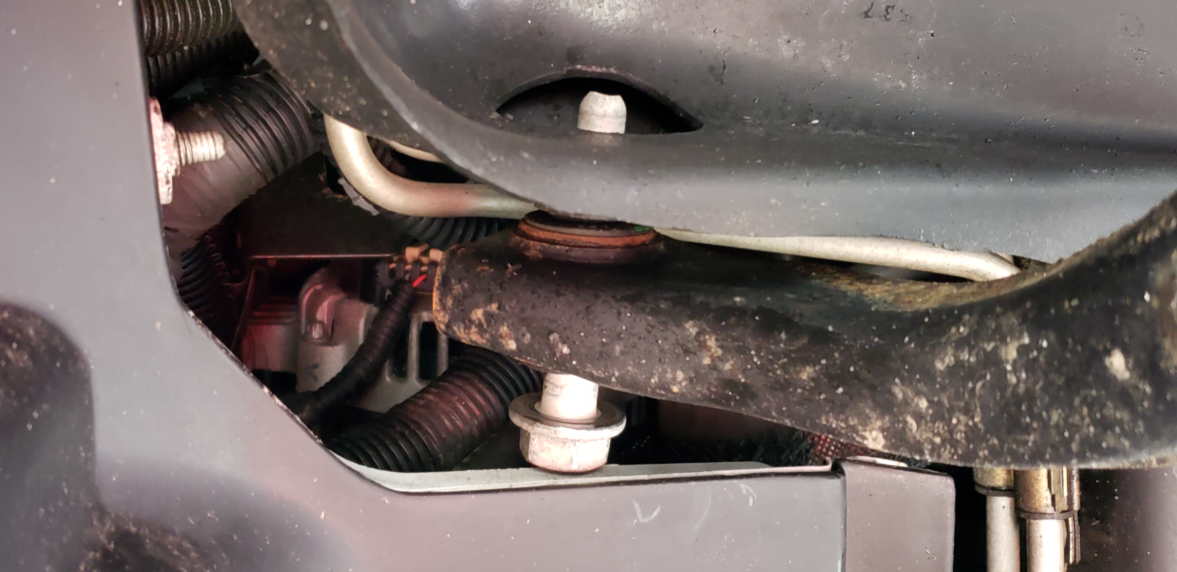

by Dudabadical » Fri Mar 08, 2019 4:09 pm
I tried to do this without cutting. Had success with the first 3 bolts. Ran into this on the last one. Lol. Oh, well. Time to bust out the sawsall. Thought about cutting the bolt shorter, but I have a feeling I might have to undo this again anyway.
Front driver's side.
Dudabadical
Posts: 13
Joined: Mon Jan 28, 2019 8:56 am
by Trail X » Tue Mar 12, 2019 10:09 am
Welcome to the sheetmetal cutting club Nick, I think all 4 of mine have cuts in them to get my longer bolts in.
