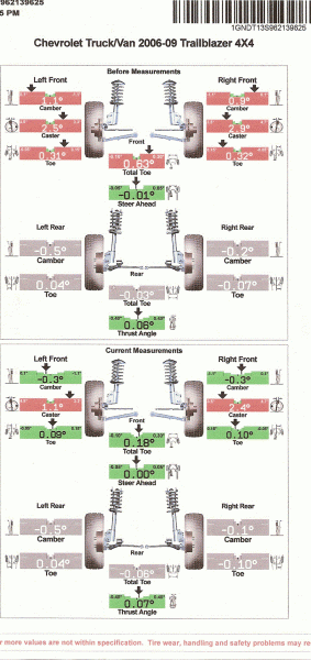

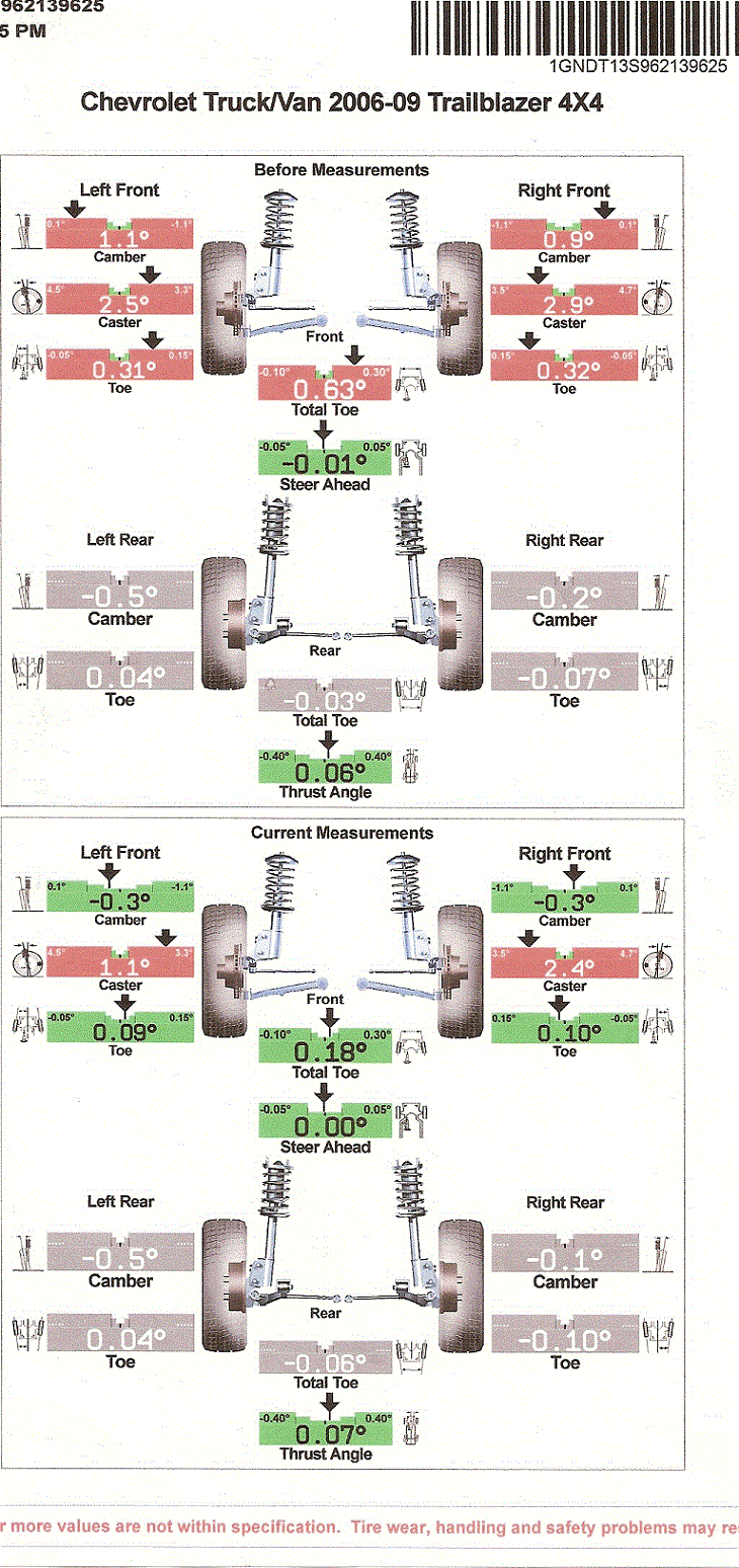

by navigator » Tue Jan 17, 2012 4:38 pm
ok, I have Mark's top spacer with the Rough Country lift.
I flipped my UCA's.
Only the caster was out when they finished and he said he dropped it as far as he could to get it where it was.
by The Roadie » Tue Jan 17, 2012 5:00 pm
navigator wrote:Only the caster was out when they finished ...
Of all the issues, caster is the least important to tire wear. Too much positive caster (that you have) contributes to a heavy steering feeling and possible bump steer. You're a heavy SUV. That isn't an issue. I would trade my camber issue for your caster specs in a minute. :cheers:
