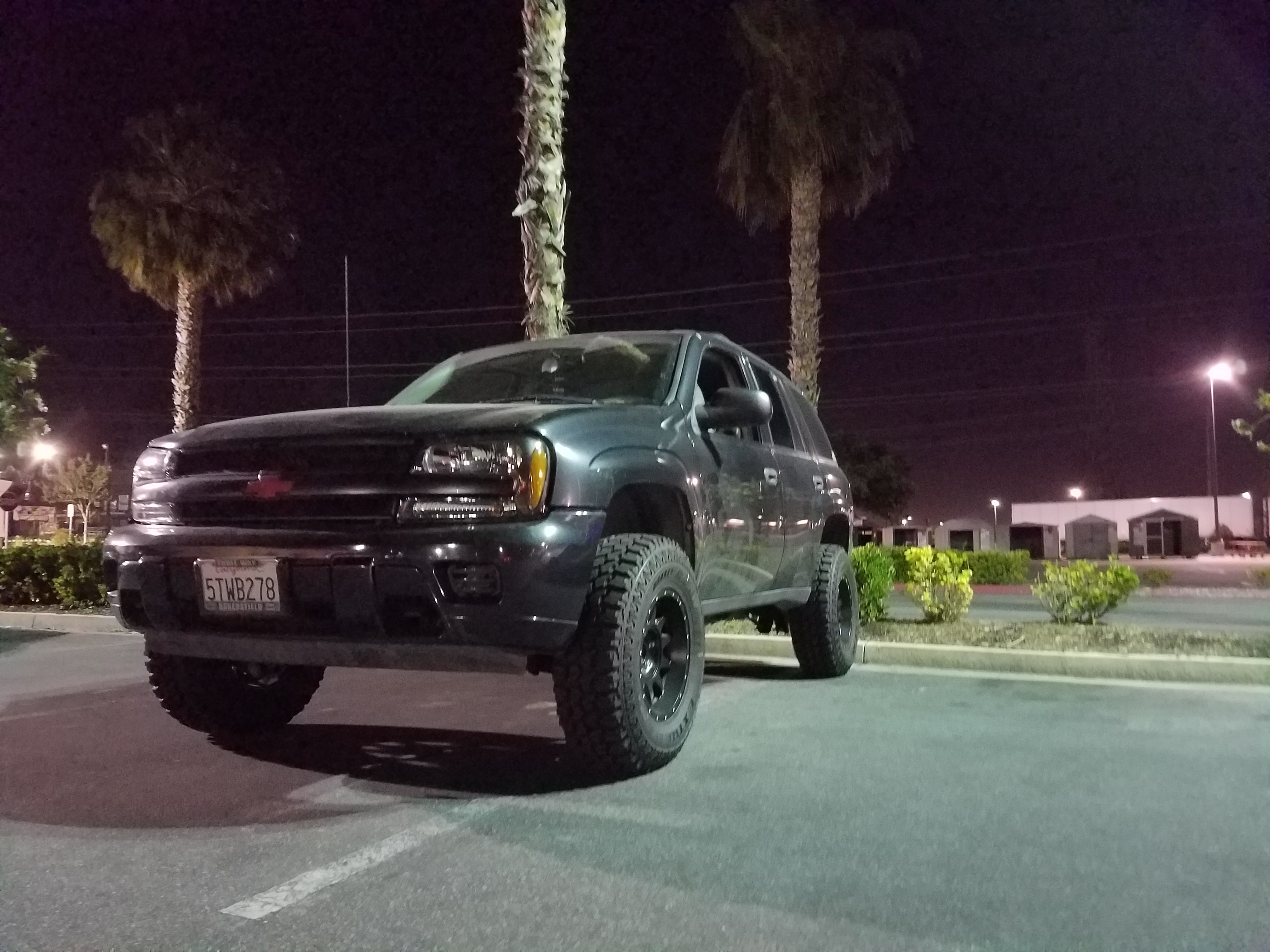

You need at least 0 offset to run oversized tires without spacers. I went -12 when I did it.
I'm currently running -12 offset 17x9s, with 1.5" spacers and 35x12.5 tires.ImageImageImageImage
by Rickalicka18 » Wed Jun 07, 2017 1:17 pm
Dang, looks awesome Mason! I'm glad the rigs back on the road. Would you be able to measure the clearance you have between the tire and balljoint for me? I want to upgrade to 33x12.5 next time I get tires, was wondering if my rims have enough offset to clear the balljoint

by mason10198 » Thu Jun 08, 2017 1:29 am
Yes, I've got about 4.5" total suspension lift and another 3" of body lift.
And Ricky, the ball joint clearance is about 2", just remember I'm running -12 offset wheels AND 1.5" wheel spacers.
by Rickalicka18 » Thu Jun 08, 2017 9:25 am
mason10198 wrote:Yes, I've got about 4.5" total suspension lift and another 3" of body lift.
Yes! My rims are -12 too so In theory I should have about a half an inch of balljoint clearance left with those tires
