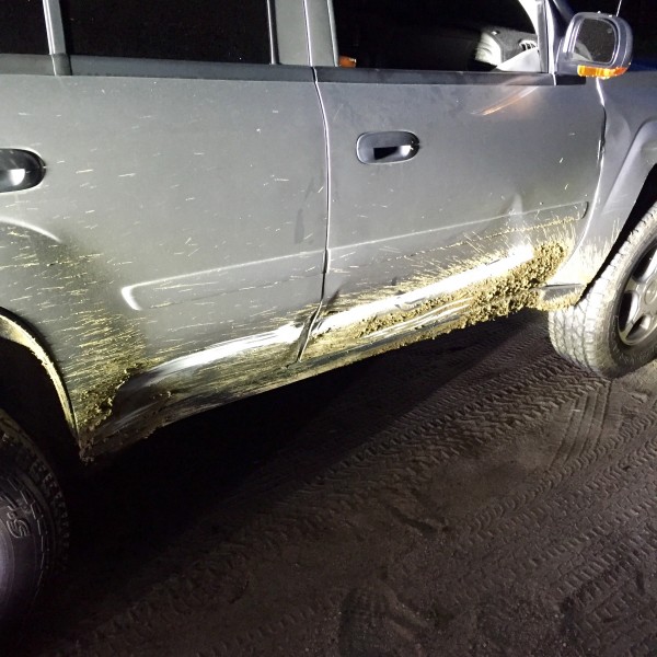

by Rickalicka18 » Wed Jun 29, 2016 12:21 pm
I think he may have laws on how much the wheels can stick out in his area. Believe me, if I didn't have laws on it in Maine I would have gone with 285/65/17 tires... Might have prevented my door damage too lol...

by HARDTRAILZ » Wed Jun 29, 2016 12:38 pm
Sliders would have prevented that much better than any tire/wheel package
by Fisker » Wed Jun 29, 2016 12:52 pm
:Iagree: is saw that and started looking at rock sliders lol

by Rickalicka18 » Wed Jun 29, 2016 2:36 pm
Very true. I'm working on the rock sliders haha.
