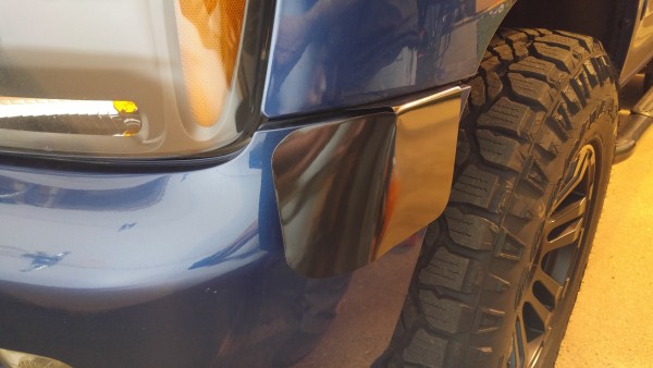

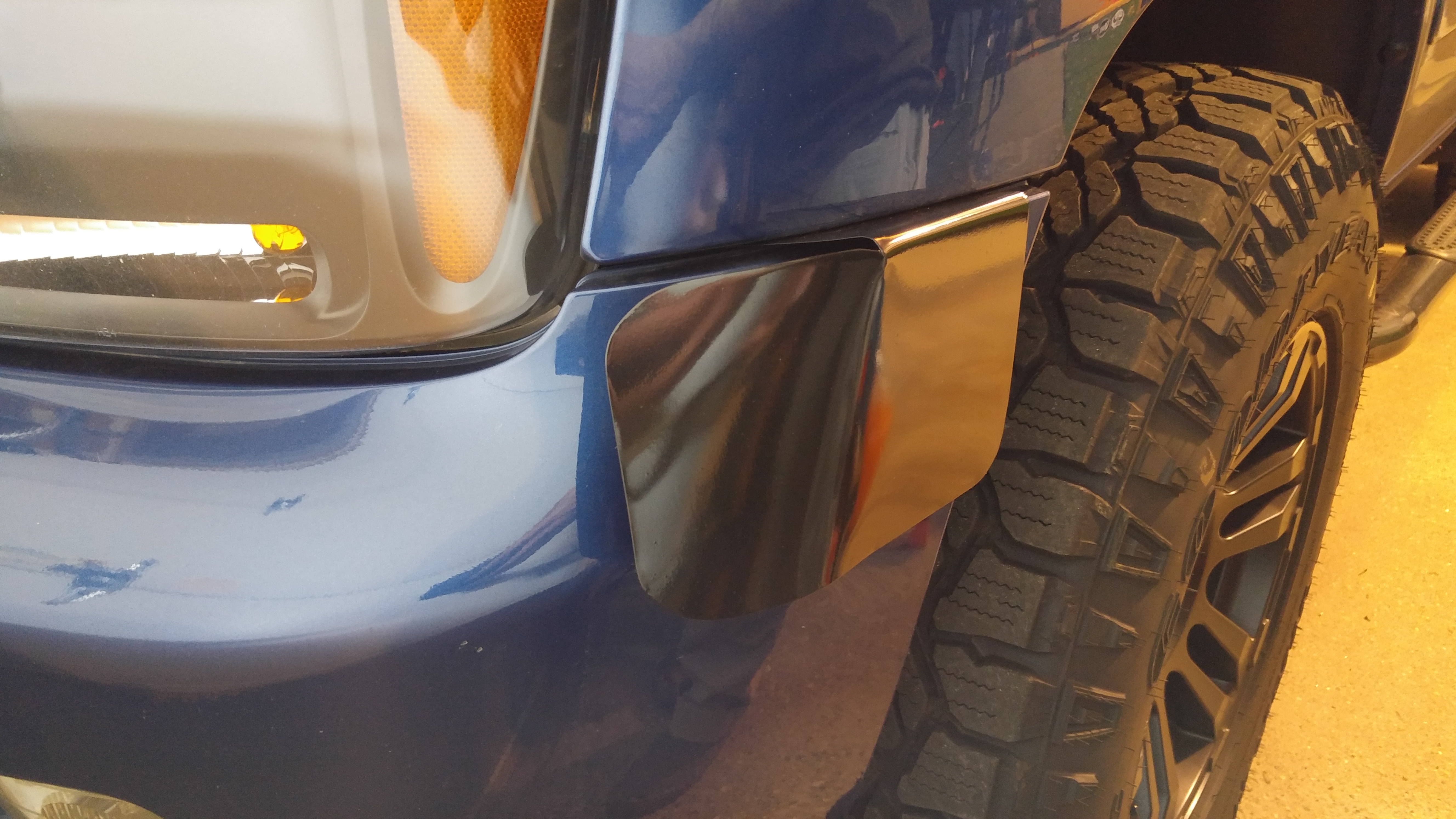

by PROSPHOTO » Tue May 10, 2016 9:18 pm
The new wheels are 25mm, vs factory 50mm offset, so roughly about 1" further out than OEM
It's hard to tell the difference from these two pictures (with and without the spacers); I'll try to get a wider picture tomorrow
Wheel/tire without the spacer
Wheels/tires with 1.5" spacer
-Mike
