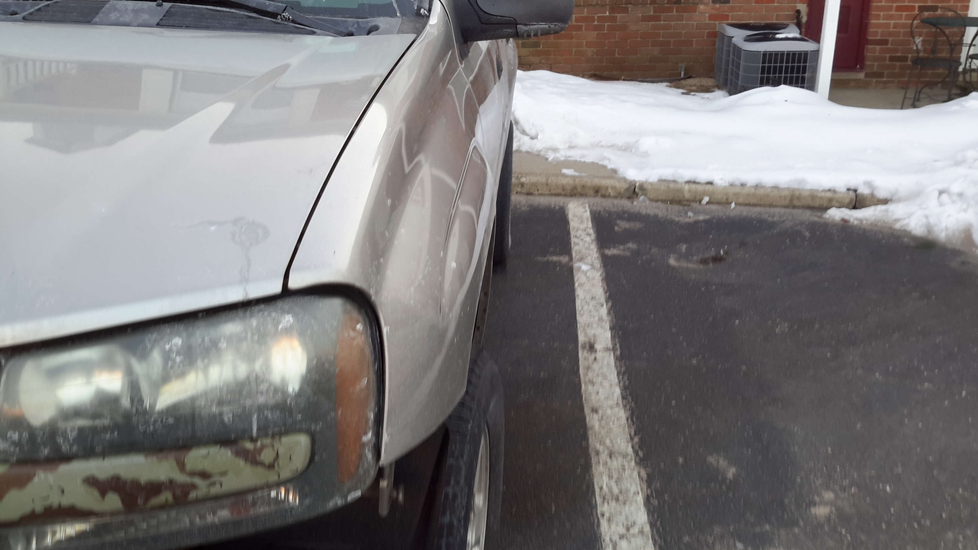

Here's a pic of 1.5" spacers with stock wheels (16x7, +50 offset, 6" backspace) and stock tires (245/70-16, 29.5"x7"). This set up lands you basically even with the wheel well.
The wheel spacer effectively moves the center hub plane over creating 7.5" of available 'backspace' at this point. HOWEVER, anything over 30.5" tall will NOT clear the upper ball joint. I'm stating this because as far as the ultimate plan of 32"x11.5" I don't think you will be able to stuff 11.5" of tread width under there and not extend past the wheel well. I think that width would require at least a 8.5-9" rim too. (Stock is 7" with 6"bs... 9" rim would probably be 2-3" out past the pic above).
