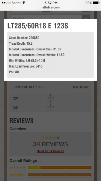

Cool, thanks for the info. I think I 'm going to look at a set of 285/60/18 Nitto Terra Grapplers now. There are a couple lightly used sets for sale around here that I can pick up for a decent price.
I'll keep you guys posted.

by navigator » Sun Jan 03, 2016 12:10 am
If you aren't going to offroad, you likely don't need load range E tires.
by oefootball_70 » Sun Jan 03, 2016 1:06 am
My issue is I don't want street tires, I need something that can get me through snow when we get it and into a field to shoot in. But not actual off-road conditions. Just sloppy mud, ruts are already dug in.

by navigator » Sun Jan 03, 2016 10:12 am
Most offroad tread patterns come in a load C for normal use or a load E which has heavier/stiffer sidewalls which are good for heavy towing or better puncture resistance when off road.
