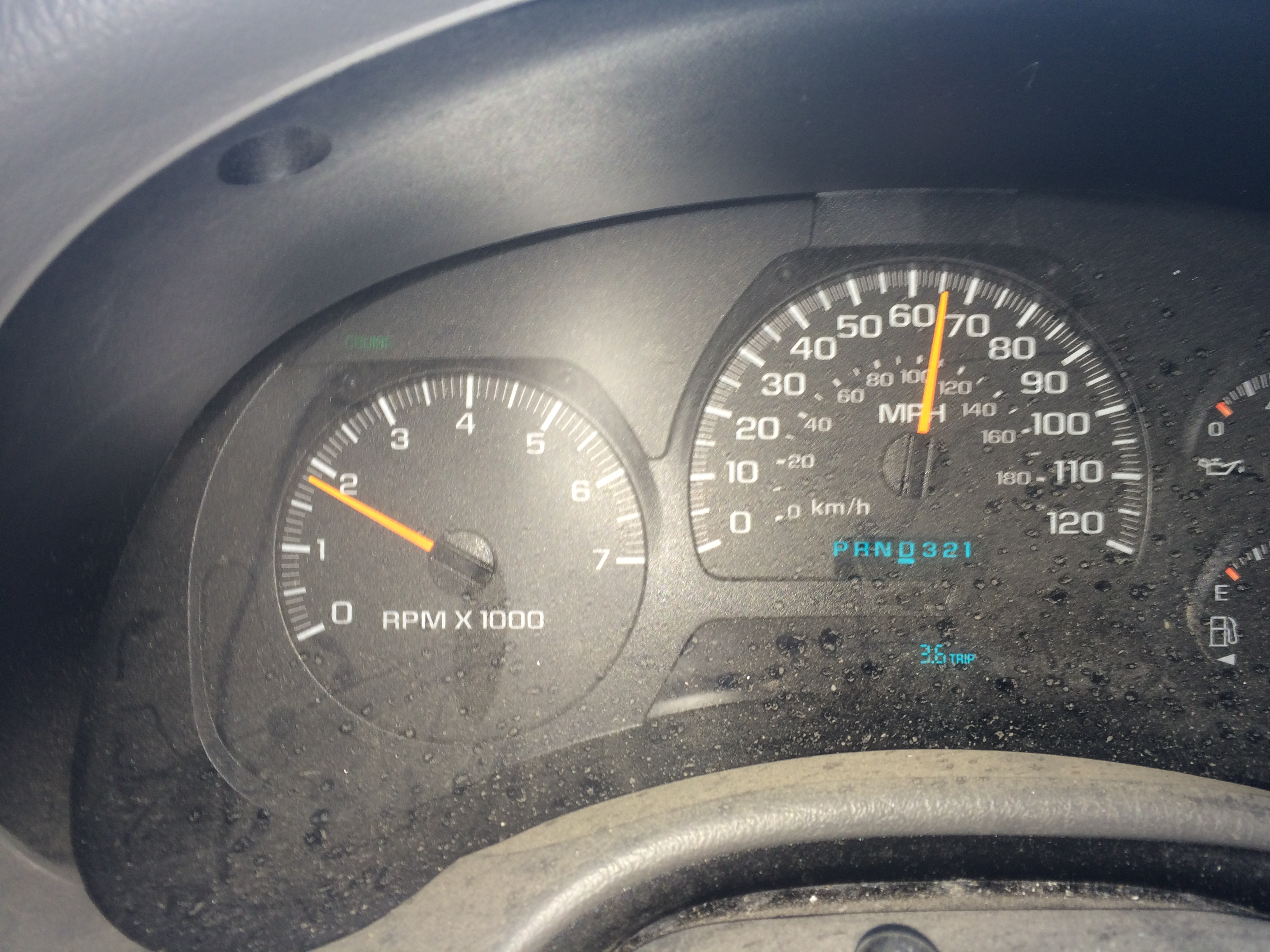

by N7RMK » Wed Dec 17, 2014 11:12 pm
ok so i have 3.42 gears and run 30.5" tires. at 65mph (gps confirmed) I'm running just a hair over 1800 rpm. according to the chart i should be 1704. am i missing something here?

by N7RMK » Thu Dec 18, 2014 12:33 am
If you look at the pic the speedo is reading 66 mph. The GPS read 65mph sustained for miles . The tach is at just a hair over 1800 also sustained for miles. So again I ask what am I missing here? 65 mph 30.56" tire hair over 1800 on tach

by Shdwdrgn » Thu Dec 18, 2014 12:40 am
No I think he's referring to the 100rpm difference in his tach... The numbers used for the calculations are based on what GM provided for a brand new system without any wear. You might have old transmission fluid, or slipping clutch plates, but my guess would be that your tach needle is simply inaccurate. Nothing on the dash can really be trusted. The only way to know for sure what your true RPM is would be to hook up a scanner to the ODB-II port and get the exact reading directly from the computer.
And if you really want an accurate comparison, you have to take into account that your speedo is showing 66mph (at which the chart says your tach should read 1731rpm). If your tires are completely worn down, that could make a difference of 1/2" or more, accounting for another 30rpm. Did you check your manufacture's website for the 30.5" diameter, or did you just pick that off of a general calculation for your tire size (any given size can vary by 1/2" diameter or more depending on the manufacturer and how aggressive the tires are)? Were you going up hill, down hill, or on a level surface? Was your torque converter locked? The point is, if you want to try and chase down a 100rpm discrepancy, then you need to get extremely accurate with the numbers you are using for your calculations.

by N7RMK » Thu Dec 18, 2014 12:46 am
Manufacture spec is 30.56 tires are maybe 5% worn. Level ground cruise control set (if that maters)
