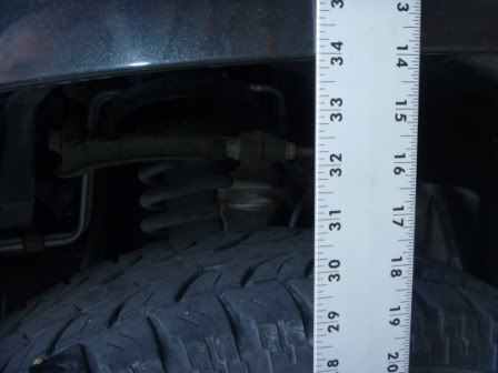

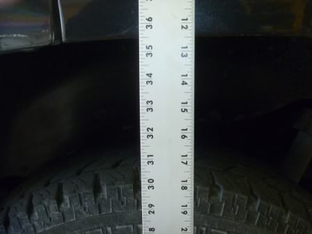

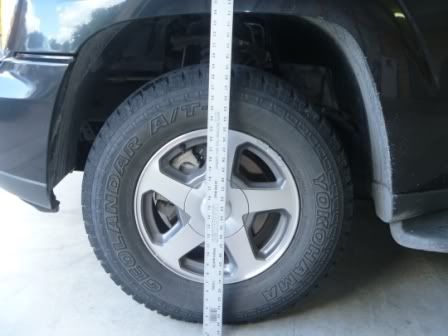

by Beamer » Sat Aug 13, 2011 6:06 pm
MrSmithsTB wrote:I have test fit 265/75/16 BFG all terrain tires without spacers. They just barely hit the ball joints. I would imagine that they will fit with a little grinding at the very most.
I took the above info and ran with it...
I have 2" suspension lift front and back and no wheel spacers.
2" lift with stock 245/70/16 Yokohama Geolander AT/S's.
Front
Rear
A "little grinding" was necessary on the upper ball joints, I used a flapdisc instead of a traditional grinding wheel to keep the heat down so it did not cook the bearing.
New 265/75/16 Yokohama Geolander AT/S tires on!
Front
Rear
New rear height
No other modifications were needed!
