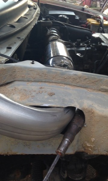

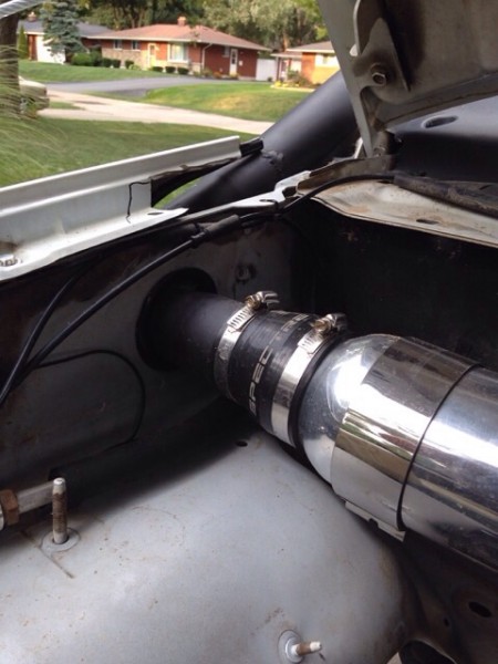

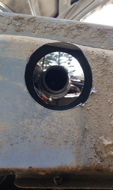

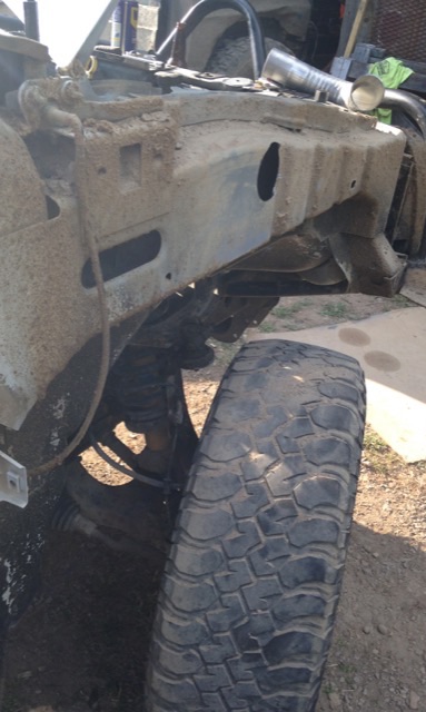

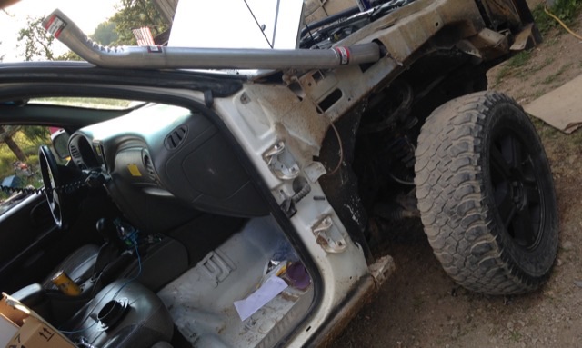

by tarsh » Wed Sep 02, 2015 8:10 pm
Yes i realize there is a hole under the pre filter, I'm going to cut a couple inches off to get the pre filter down a bit. Hope you guys like it. I beg for your feedback and ideas! Happy trailing guys!!

by moose1 » Wed Sep 02, 2015 9:16 pm
I like it, nice job. next up exaust through the hood?

by Trail X » Thu Sep 03, 2015 10:57 am
Looks good! I hadn't considered going straight out of the throttle body across the engine bay laterally. I had always pictured going further down the engine bay and not touching the radiator overflow tank. Pretty clean though, overall.
Thanks for doing something new and documenting it! Often once one person paves the way, others will follow.

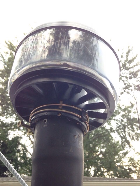

by AA1PR » Wed Jun 01, 2016 6:34 pm
tarsh wrote:She's been updated a bit since the last photos there lol iv gotta update.
nice work, what was updated?
1966 Stevens M416 trailer too
AA1PR
Posts: 185
Location: Vermont Mountains

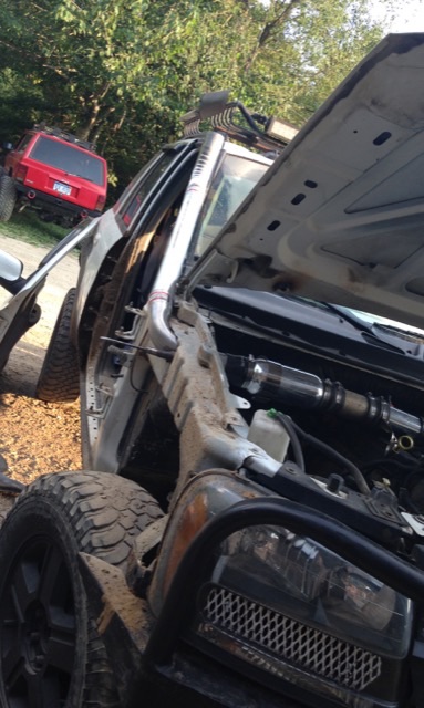

by tarsh » Wed Jun 01, 2016 6:57 pm
I have upgraded the inline air box from the scepter 3"inline filter to the K&N Apollo series inline filter. So far so good. More airflow with this set up. Iv also tried a few air rams avg found one by tjm Offroad that contours the tb pretty well. If i remember I'll update. It's been holding up very well for me. Only ONE minor set back. I parked at work mid winter, the snow had filed the head and like an idiot i fired it up anyways. Drive ok for about 10 minutes. Then like complete garbage. No power lack of air. So i pulled over to have a look. The entire filter was packed with snow/ice. After chipping for a few all was well

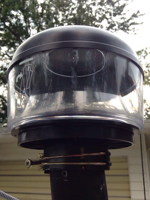

by tarsh » Wed Jun 01, 2016 11:14 pm
There is the newest air ram

by v7guy » Thu Jun 02, 2016 12:35 am
Given the water mishaps guys have been having I've been giving this a lil thought as well.
Tarsh, have you tried different heads on your snorkel?
Have you noticed anything that you'd like to change about it since living with it for awhile?
