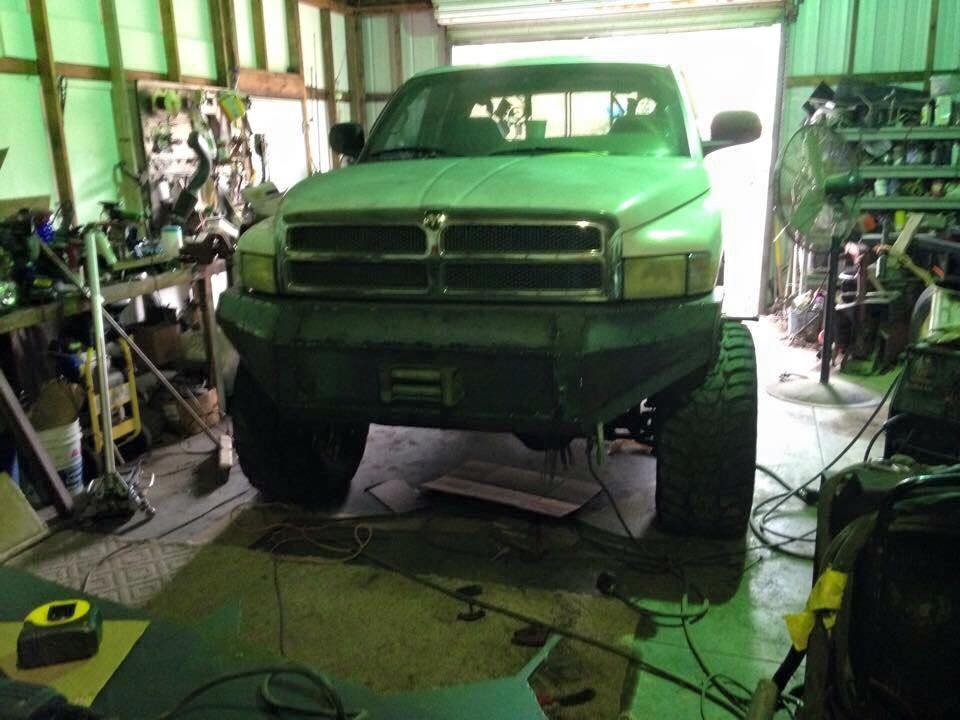

by Codyj92 » Mon Jun 08, 2015 5:38 pm
Thanks man. It's gonna be a learning experience cause all I've ever messed with is jeeps. Currently trying to open up my own offroad fabrication shop so that should help fund it
Some of the stuff I've built and my company name
