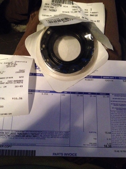

:mechanic: so, i replaced my exhaust doughnut yesterday and i noticed it was really wet under the engine on the driver-side. got to poking around and found the front diff is leaking bad probably due to 170,000 miles and constant offroad use of 4x4 since i got it. my question to you guys, can i replace the outer seal of the front diff without taking out the front differential? its leaking right behind the cv shaft. if not does anyone have a part # or a link for me? i now i havent been on in a while but help me out :finger:

Yes, you can replace this seal w/o removing the front differential. Get the GM seal, not an aftermarket brand for best results. There may even be someone who has done this already if and put up a post if you do a little "searching"

Just did mine a few months ago. I had a lot of trouble finding the right seal. Every part store in town either gave me the wrong part, or did not have one in stock. I finally ordered one from gmpartsdirect.com, the part was back ordered. When it finally came it was the wrong part also(can't return a special order part to them). I ended up just going to the Chevy dealer, they had it in stock for around $17.00.
Get a seal puller if you don't have one, or you might spend all day cusing at your truck. Grease up the new seal, clean and grease the housing. Knock in the seal with a block of wood, make sure it starts going in square with the housing so it dosen't deform the seal.

It's part #19257296. My searching on gmparts.... lead me to part 12479302, WRONG. This is the seal for the passenger side cv on the disconnect, the web site listed that part # for the diff and the disco. Hope nobody else has this happen.

I managaed to get to the gm dealer today. 16 bucks. While i was there i figured i would ask about the 89 spring just to see. As it turns out the had no such part number for the trailblazer. But he said "im going to see if gm changed the number" wich they didn't. He only had the 85 spring listed. In a later search it came up with just the 2 wheel drive gmt360 platforms had that spring but couldnt say for sure that it even existed. The in a nother search he looked at the SSR, the 2006 model year and it came up with the 87 88 89 spring. Maybe i stumbled apon some infomation of use here, not sure. The price was a hefty 137 bucks :scratch: i found it interesting :!:

:salut: O yeah, im sure many know but here is the gm factory part number for the seal #19257296
