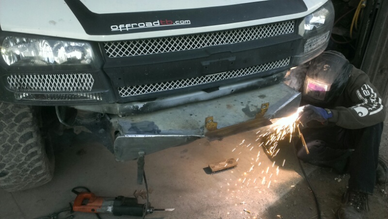

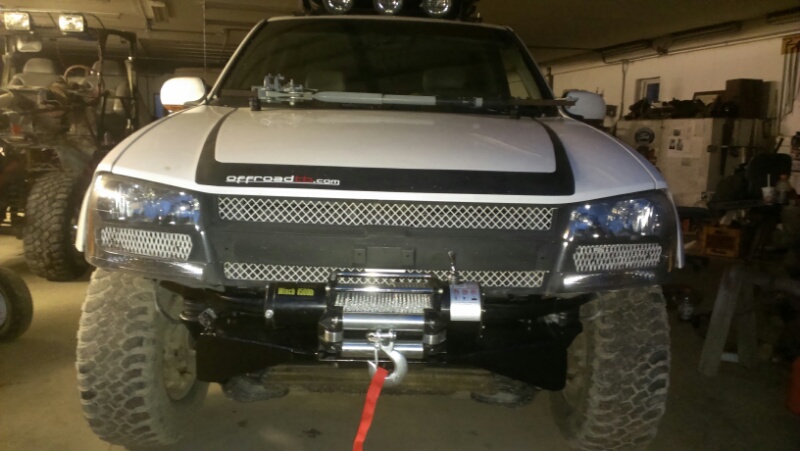

by tarsh » Sun Mar 30, 2014 9:50 pm

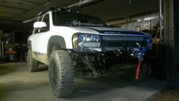

Got it mounted. Spent allllll day fabricating a mounting plate. I have a few pics if your intrested. I just don't want it to fail me. So, it should be OK if I do some of my own waterproofing?

by Trail X » Mon Mar 31, 2014 4:36 pm
How about some more pictures of how that thing attaches to the frame?
Your radiator looks very susceptible to damage. I'd work on that before the winch mount.
Posts: 9935
by tarsh » Tue Apr 01, 2014 8:40 am
Its welded directly. And I'm working on a skid plate at the moment.

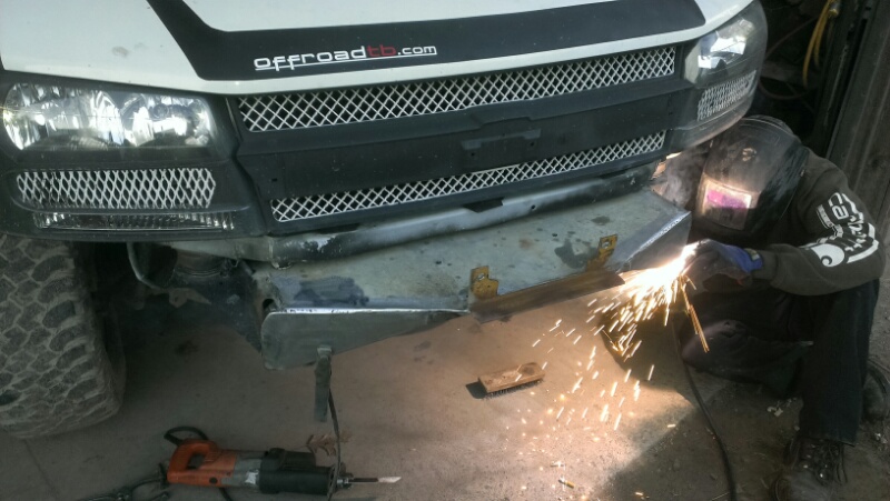

by Trail X » Tue Apr 01, 2014 8:46 am
You welded your plate directly to the frame? Interesting.
What thickness did you use for the main plate?
Posts: 9935
by tarsh » Tue Apr 01, 2014 8:58 am
Its like almost 1/4 inch plate. Idk if you know anything about cellphone tower's but its a port hole cover from a mono pole. Heavy duty stuff. Same stuff the huge Steele power line poles are made of. I have some square stock in the front that's knotched out for the winch hardware. I'll take some picks of the whole thing later.

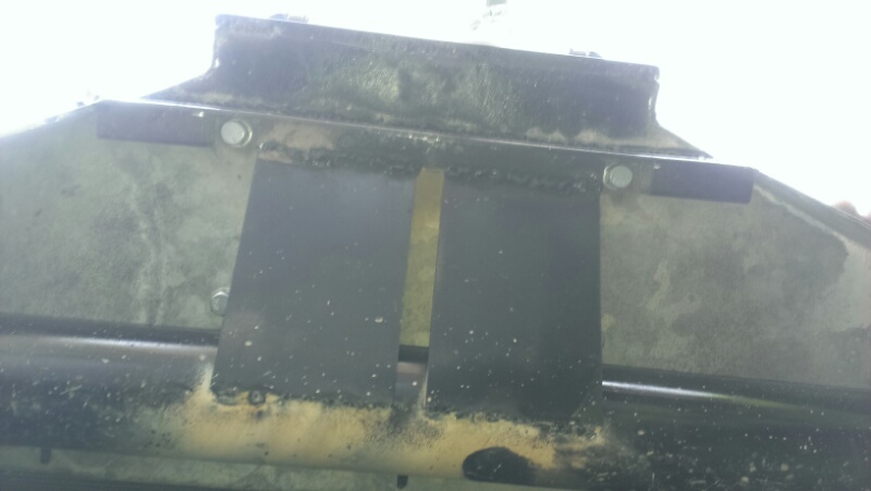

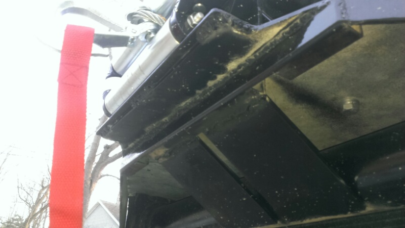

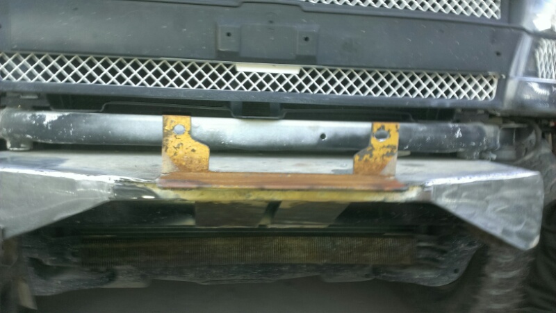

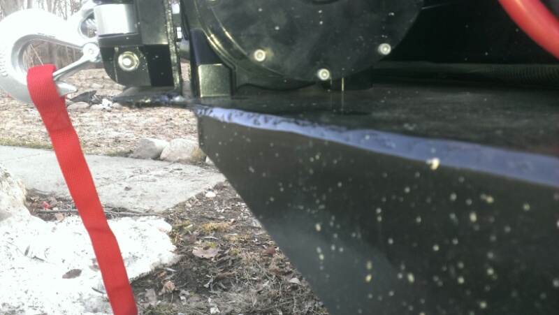

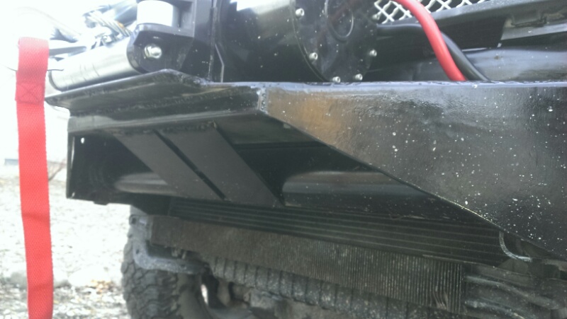

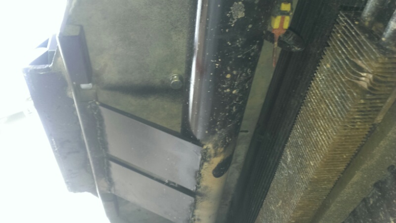

by v7guy » Wed Apr 02, 2014 6:21 pm
Nathan, did you put any reinforcements on the under side, or a lip on the back edge of the plate? I ask cause it doesn't look like it.
Most of the winch plates that are sold have a lip at the back edge and they are actually 1/4" plate. Not to mention they're not as large as the plate you and I have... so with the larger flat plate there's more leverage being put between the winch mount bolts and the frame rails, I could see the possibility of the plate flexing... especially when the pull is at an angle.
I've been using the 3/16" plate winch mount plate for a good while now and with the ribs on the underside and the lip at the back I haven't had any issues at all. I wouldn't have even thought to add those things if Mike hadn't suggested it. But it makes sense in hindsight and after looking at other products. By you saying it's almost 1/4" I'm guessing you've got something about 3/16".
Your plate will probably be fine, but I'm of the mindset that something that's too much is better, especially when you're stuck in the middle of nowhere.

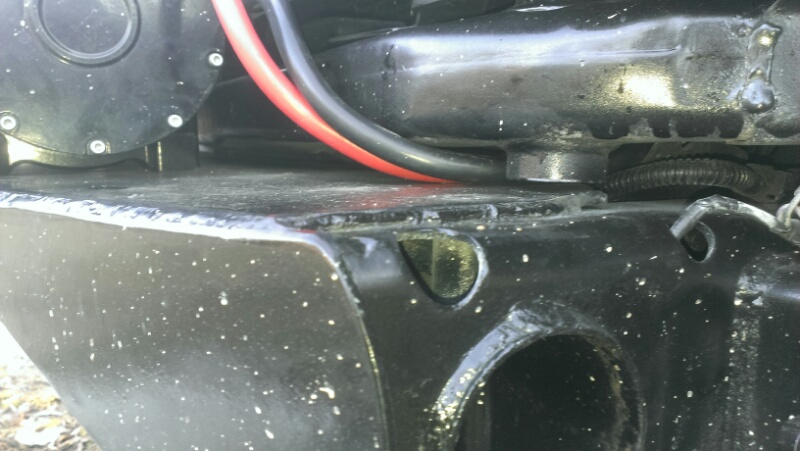

by tarsh » Wed Apr 02, 2014 7:39 pm
Take the path less traveled
tarsh
Posts: 483
Location: MI, Holly
Name: Nathan Schroeder
by tarsh » Wed Apr 02, 2014 7:40 pm
tarsh
Posts: 483
Location: MI, Holly
by Trail X » Wed Apr 02, 2014 9:39 pm
Not to be picky, but those look like some porous welds. Also, you really need to wrap your weld at the back corners of your plate. That's a perfect place for it to begin to unzip.
I also have no real good reference in your pictures, but a lot of that looks like 10 gauge plate. I'd get a good measurement on the thickness of your main plate and report back.
And honestly, I'd grind out and reweld a lot of your seams.
Posts: 9935
