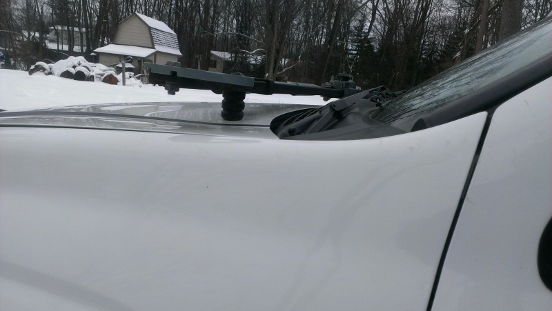

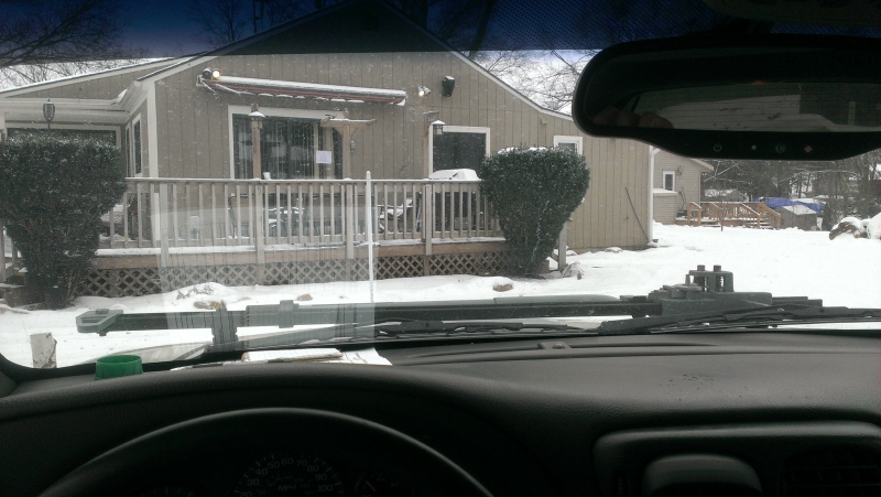

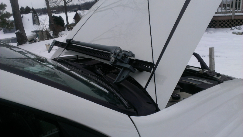

as i said i would put up some pics. here you go :)

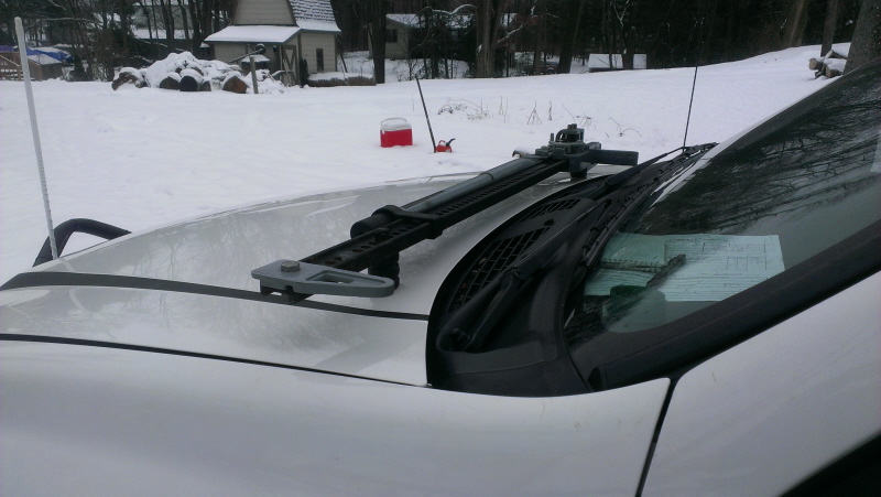

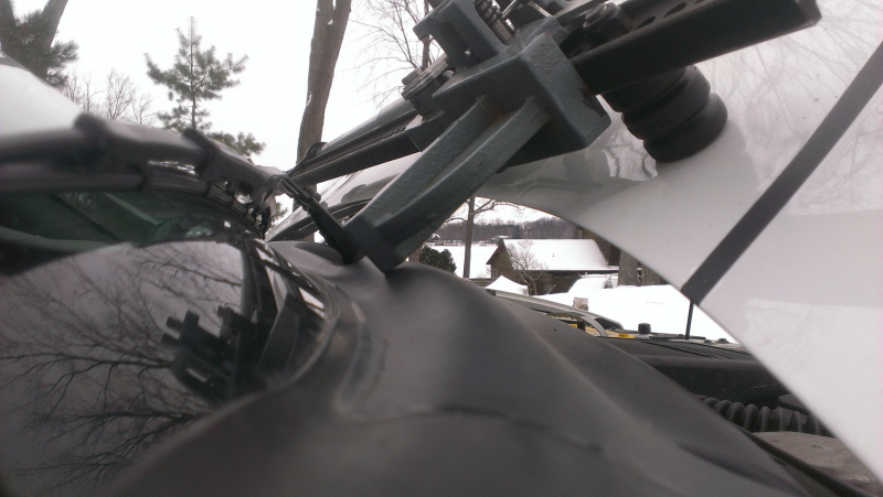

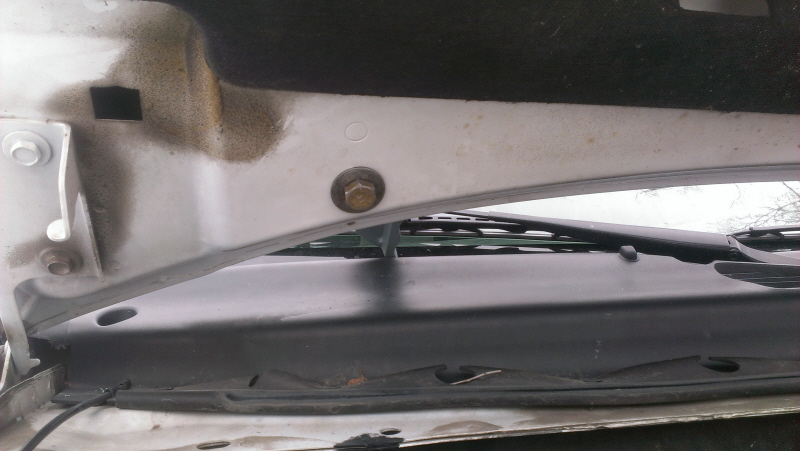

by tarsh » Wed Jan 01, 2014 12:24 pm

I'm with Navigator. I'm too short to put something that awkward on the hood of my truck without damage. I must admit, it looks better on the hood than I expected. The black really helps. Is one bolt on each side enough? They are pretty heavy. I think I would be worried about warping the hood sheet metal. I see the washer on the bottom, that should help.

IMHO This mount looks interesting and like a projectile at the same time. I hope you used grade 8 hardware. Do you have a way to lock it?

I'm 6'2" so I can reach out and do it. I don't have a way to lock it.but the trough bolt is in a steel sleeve in that bump stop and will spin if u try to loosen it.the bolts are shackle bolts from my little brothers YJ so I'm sure they are strong enough.if still got some ideas on beefing it up a bit.yes, my base is detachable wich was convenient.it's a 54" trail jack. It does warp the skin but I figure a long piece of steel across the hood,hole to hole would fix that.

the standoffs on top of the hood appear to be "not metal", that would worry me a bit as I can see the jack shifting back and forth under braking and accelerating and wallowing out the holes you drilled and work hardening the sheetmetal. This in addition to the small washer on the underside doesn't give me warm fuzzies. I'd feel better with a larger plate sandwiched between the bolt and the bottom of the hood to spread out the forces across more of the sheetmetal. I'm no engineer or nothin though, I've just read their thoughts for quite a few years, so some stuff jumps out at me.
It looks like a pretty serious visual obstruction to me. But if you're comfortable with it that's all that matters.

Oh actually got a steel sleeve inside that boot.

I am going to agree with everyone else, structurally this doesn't look safe. those holes are going to wear, it is not very thick sheet metal. Some bouncing around on the trails, a few hard stops, and that will become a missile into someones vehicle.
That said, it does look good from the outside of the vehicle. However, what it doesn't look like is a functional mount. From the looks of it, to remove it on the trail you will have to completely unbolt it from the hood. It doesn't look like it would be a very user friendly set up.

It is actually a little more structurally sound then u guys think. I can grab it and shake my whole blaze around.I'm not sayn you guys are wrong but nobody has done this that I know of. Therefore nobody knows what will happen. It does have sleeves in it so it's quite strong. Trial and error. That's how we got our rigs where they are today. As far as the user friendly go's, I can easily lift it off, I just need some lock washers and wing nuts. I thought about coder pins.

Hope it works well for you. Seems pretty solid except for maybe making a larger plate on the under side instead of the basic washer.
