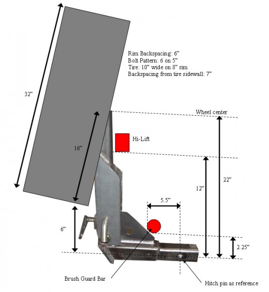

I just walked out to my truck, fully intending to come back in with the measurements you need... completely forgetting that I have a custom rear bumper. Doh.
Not sure if this will help you at all, but the measurements I initially sent CBI are included in the picture below. (I had a rear brush guard at the time that I wanted to make sure didn't interfere with the tire carrier.)

by jhberria » Tue Aug 20, 2013 1:12 pm
That may prove to be incredibly helpful, James. I appreciate it. I'll probably take those measurements and adjust to compensate for my lack of a rear brush guard.
