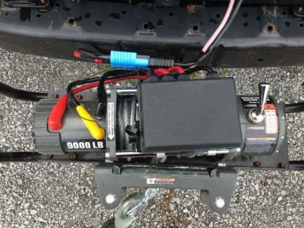

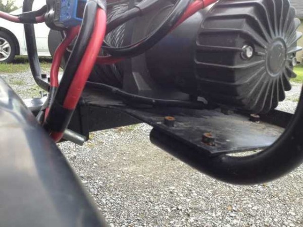

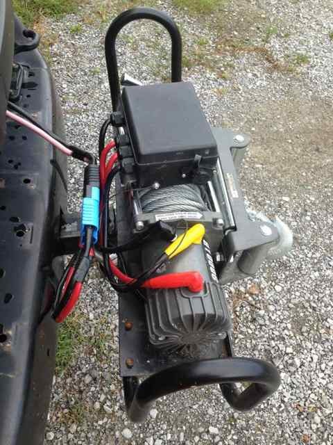

I did a little mock up of the winch mount I'm wanting to build.
Has anyone considered notching the top plate to move the winch back further?
by Shdwdrgn » Sat Aug 17, 2013 9:01 pm
What about raising your plate slightly so that it slides over the top of the hitch? Since your tow rings are right there, you might also consider extending a bar across the back side of the winch mount to sit on top of those and provide more lateral support as well (just sitting on top of the mounting points for the tow rings, not actually using the top rings themselves).
Shdwdrgn
Contributing Author
Posts: 439
Location: CO, Longmont
by ErikSS » Sat Aug 17, 2013 10:07 pm
That was another thought I had. I'm not sure I would use the tow hooks in any way, but raising it above the lip of the hitch might serve the same purpose.
by djthumper » Sat Aug 17, 2013 10:24 pm
ErikSS wrote:That was another thought I had. I'm not sure I would use the tow hooks in any way, but raising it above the lip of the hitch might serve the same purpose.
When you do that you will end up needing access to them...
by ErikSS » Sat Aug 17, 2013 10:32 pm
djthumper wrote:When you do that you will end up needing access to them...
I would still be narrow enough to access them. I'm thinking I would move the winch up 3/8" then back 1 1/2" or just straight back. I worry bringing it up will cause weak joints. I'm waiting for Barton to put his 2 cents worth in here. I'm sure (and hoping) it's coming.
by bartonmd » Sun Aug 18, 2013 2:20 pm
I briefly considered raising the winch plate and cantilevering it back so that the back of the plate was at the front of the bumper. However, I didn't do it, because that would preclude me from putting the winch on the stock rear hitch, and many other hitches that it would/could go on, in a pinch.
by ErikSS » Sun Aug 18, 2013 6:42 pm
bartonmd wrote:I briefly considered raising the winch plate and cantilevering it back so that the back of the plate was at the front of the bumper. However, I didn't do it, because that would preclude me from putting the winch on the stock rear hitch, and many other hitches that it would/could go on, in a pinch.
Ah HAH! There is a reason I ask questions before I start cutting. Thanks for the tip Mike. I intend to be able to use the winch on the front and the back.

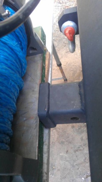

by boog2006 » Sun Aug 18, 2013 7:40 pm
Got to looking at mine after reading this thread and noticed the hitch mount has been twisted...now what to do?
